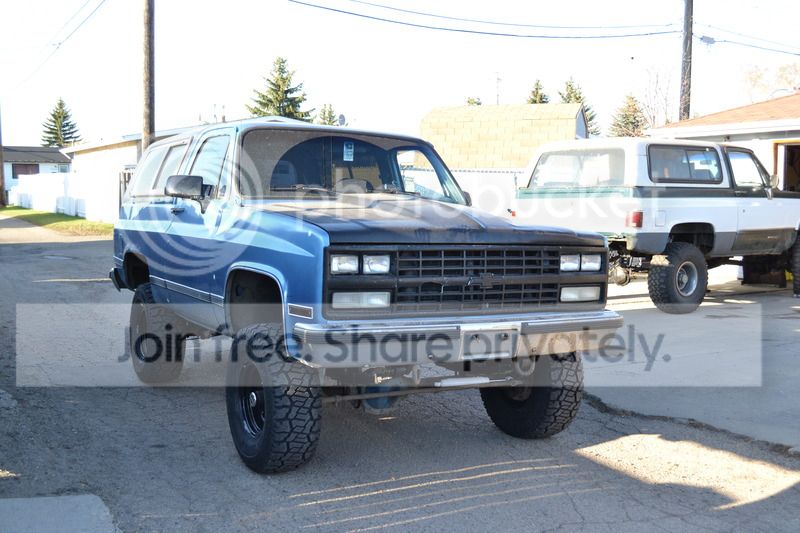

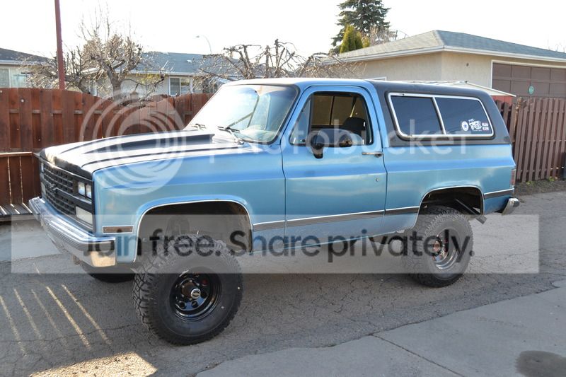

Money shot:

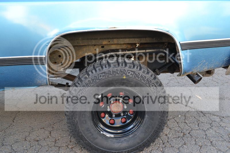

This is one side of the old 3" duals I had on my Blazer. I plan on using one side with 3" single on my Blazer with the 5.3, so this side was sitting here collecting dust. I may have spent 20 minutes installing it, and it sounds really good!

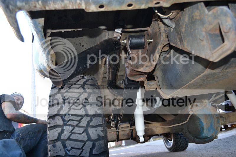

I like this routing, and have done it a few times now. It get's everything out of the way of everything...high and tight.

Quick question though, in that last pic, it looks like the spring bolt is hitting the shackle hanger. Hows the clearance there?
-Rob

I'm diggin that way you ran the tailpipe, should help with clearance I'd say.
Those bolts are close and did have to be trimmed. It'll get another look in a few days and may need a bit more taken off.

Trucks looks good, I had been thinking about running my exhaust like that for some time now and couldn't figure out why no one had done that:dunno: looks good to me!
Thanks all! Was a battle and a blast. Never had so much fun cursing and spitting rust out of my mouth. First things first, without the extreme generosity and knowledge that rene offered me, i would have either paid to have this done due To lack of space right now or it would still be in pieces trying to get the steering arm off, so hats off to him for this one! The kit from bds was good. Nicely packaged, shocks came with new studs if needed, new nuts for the bolts, one issue we did have was clearance on the bushings and the new DIY4x shackles. A little trimming with the grinder and it went together well! The springs were made in canada which was a nic change compared to china, so thats another credit i will give bds. I have read that bds springs can be very rough and have a high compression ratio. Me and rene looked and i beleive it was 490 on the leafs ( a little bit higher than the average kits ). We eliminated the sway bar, even though the bds kit came with a relocation kit, which rene claimed was different than the usual, and keeps the sway bar at the same angle with no bind. (If anyone could use this PM me and i can find shipping and send it your way as im super pleased with the ride without it). Last of all the ride is a HUGE improvement from stock, it may have been something else causing my ride to be so uncomfortable but Is eliminated now, i can hit a tiny bump without sending the whole truck all over in a hurry. In my opinion i would tottaly recoment this lift. I think it cost me about 1500 for the lift with the 5500 series shocks and no blocks. Included steering arm from pro comp, sway bar kit and a few other goodies that are nice to have for a back up.
