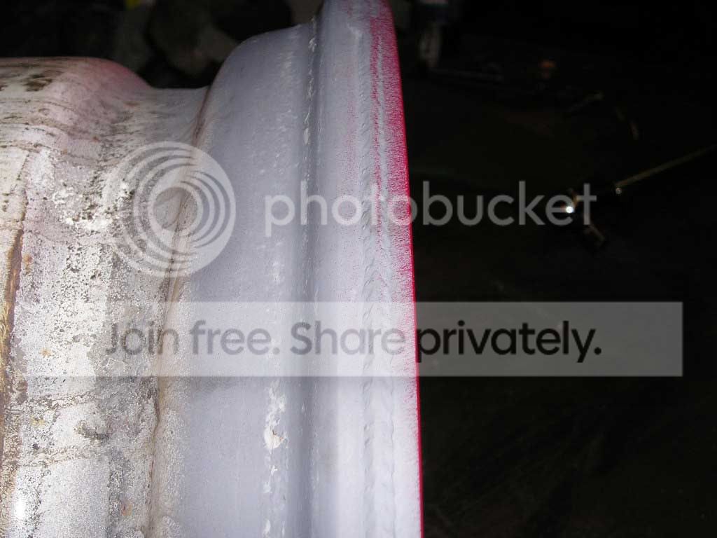

They fit loosely to the rim. There has to be a gap, so you get a good weld penetration.
Your red ring would be what we call a "inside the lip design" Meaning the inner ring drops down inside the lip. Typically easier to weld, there is a small gap around the ring with most wheels. Some wheels have the lip rolled over further so there would be less gap on these wheels.

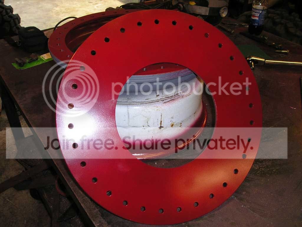

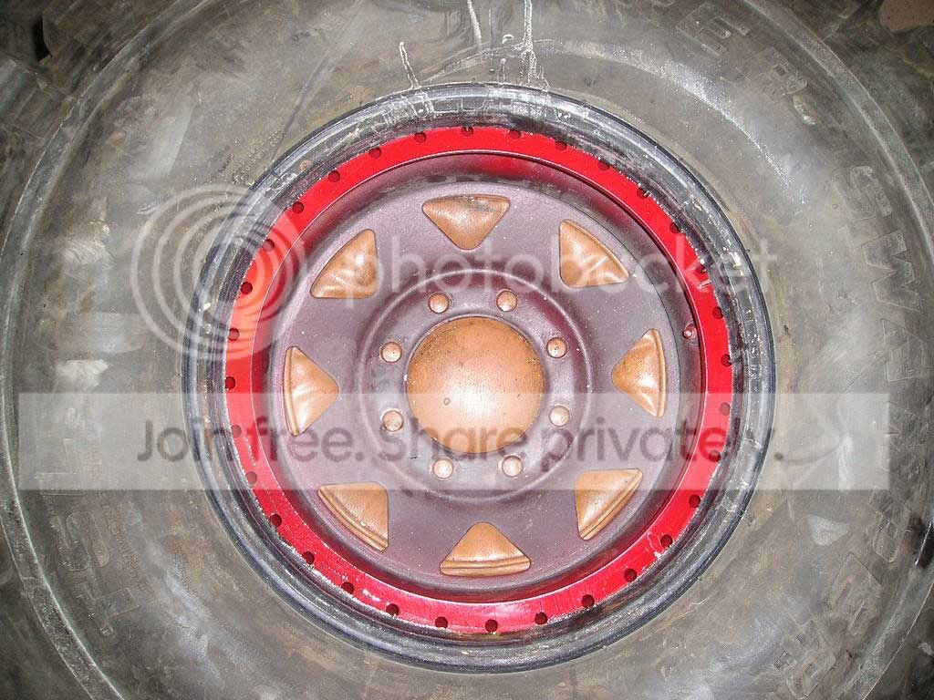

I just got through welding up some weld on bead locks that use the inside of lip of the rim. The rings I used were a little wide and didn't leave much welding room. I had to bevel the hell out of the inter locking ring to an ok gap. I would have liked more of a gap. I'm guessing I only got 70 % penetration. I hope that will be enough:confused:.

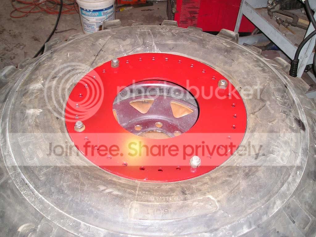

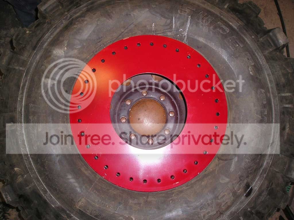

just finished welding one up last weekend and mounted the tire today. Havn't tested it yet so I can't tell ya how they ride.
Will NOT be a blast. :eek1:

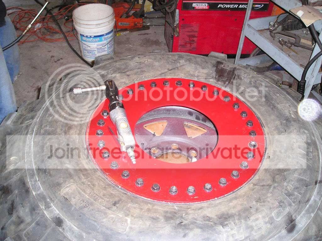

It takes a loooong time to torque all those bolts. 20-30 minutes per tire. It sucks.
That's why man made impacts.........................................................:D

seems you can torque them all day long and they just keep getting tighter as you work around. Use a good pinch type lock nut. All I have ever used is a nyloc and they have worked well. Never acutally needed to tighten later but have always kept my eye on them.
Like to get my thread stick out the same as much as I can and a visual inspection will go along way. Occassionally put a wrench on them and physically check. Visual inspections go fast and can therefore be nut alot more often.
