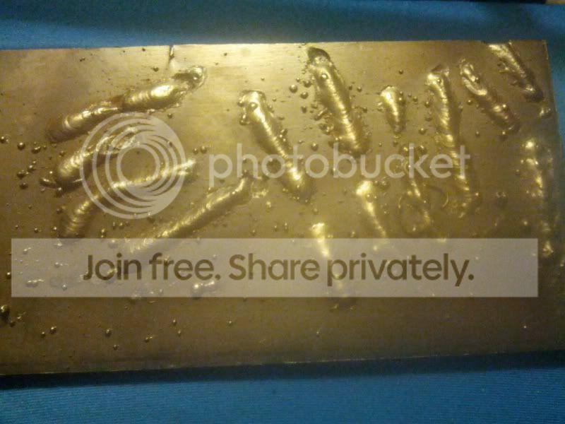

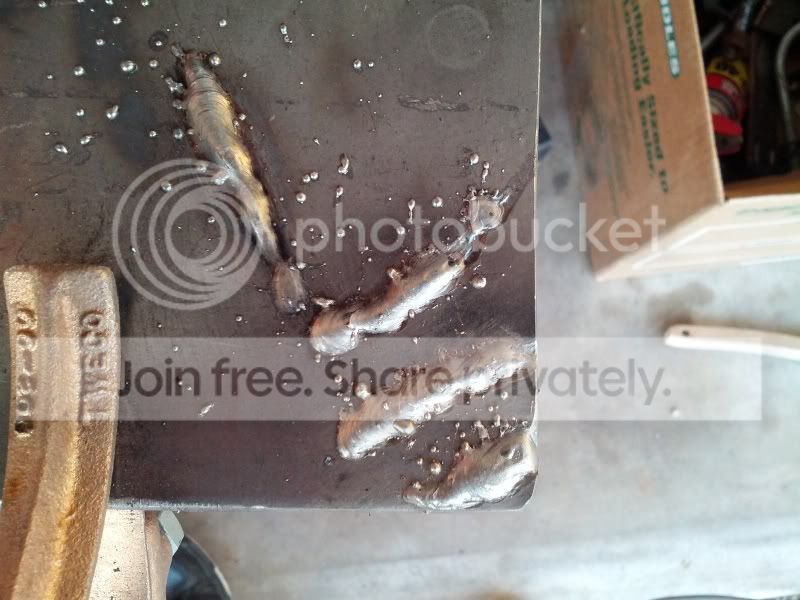

I brought over my harbor freight helmet and wow what a difference. :eek1: As mentioned above I was using a wire speed of 80 when the cheat sheet called for 60. :doah: The cleaner I have a can of wouldn't spray well but I was able to get some out. It was a silicone spray? Still having trouble with burning up the tips and not staying clean but that will come around.
The top one going vertical is my brother in laws with a wire speed of 60. The top of the 3 is my first one at 60,2nd one was at 55 and the 3rd was at 50.

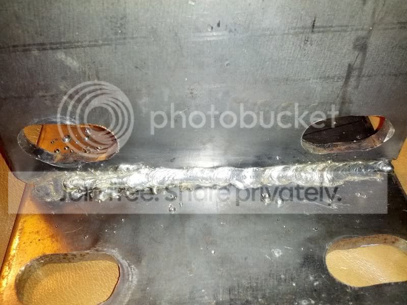

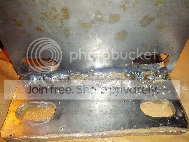

This was my final weld, I wanted to go from one side to the other.
Overall, I'm extremely happy with this and having a blast. :pimp:
Yes which is why I went down a little sense it looked a little to fast for me. Thank you, I'm extremely please with today's results vs yesterdays disaster. It can only get better from here.
and go get some nozzle dip . you will thank me .
also work the gun tip a little in to each piece in a weaving pattern kind of . it will get you a better weld .
also more weld time / heat goes in to the thicker material if to different thickness pieces .
best way is just play with scrap . :waytogo:

That last one is better but far fom good. Keep at it gun and puddle control are key. Like I said before good helmet allows you to see, and you have to see the puddle.
Keep at it

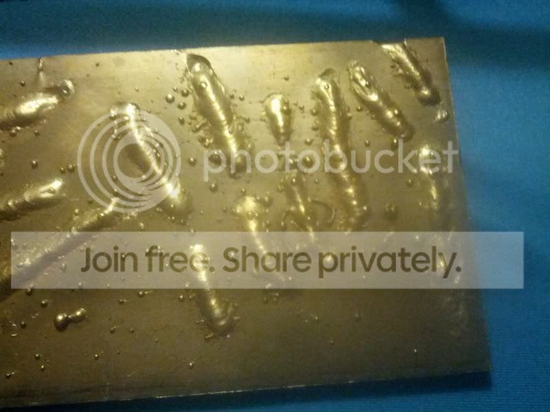

Had some more time today, not a lot but some. I'm really starting to see something now.
The 4 horizontal lines are weaving the vertical ones are e's
much better danyo son wax on/ wax off has you lookin good.

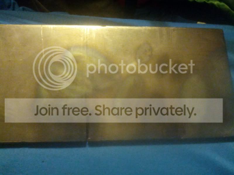

and good heat in the weld as seen on the back side.
Thank you. :D I have found I go way to slow, suggested wire speed is 60 I was between 40 and 45 on those welds.
