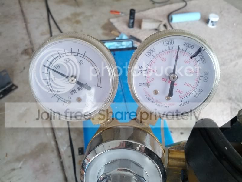

Here is the regulator. I would assume the gauge on the right is showing how much is in the tank?
Correct. And the gauge on the left will show what's coming out, but you only get a real reading when pulling the trigger. I generally run at like 10ish psi.
