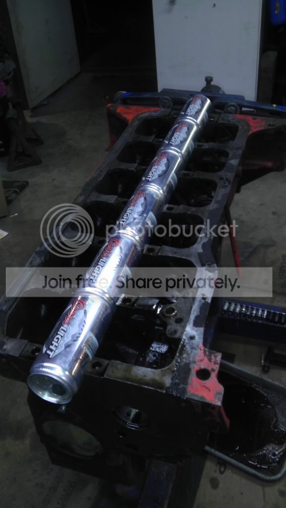

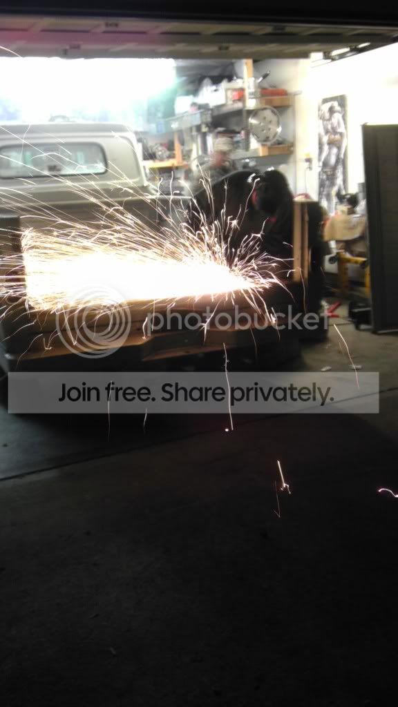

You should turn this into your build thread or at least start one! Here is a pic of the other night,
And one of the silver bullet 292,
I hope your not putting a steel bed in that, I used to have a 64...miss that more than anything I've ever owned..still have all of the trim up in the rafters (for when I get another one someday)
