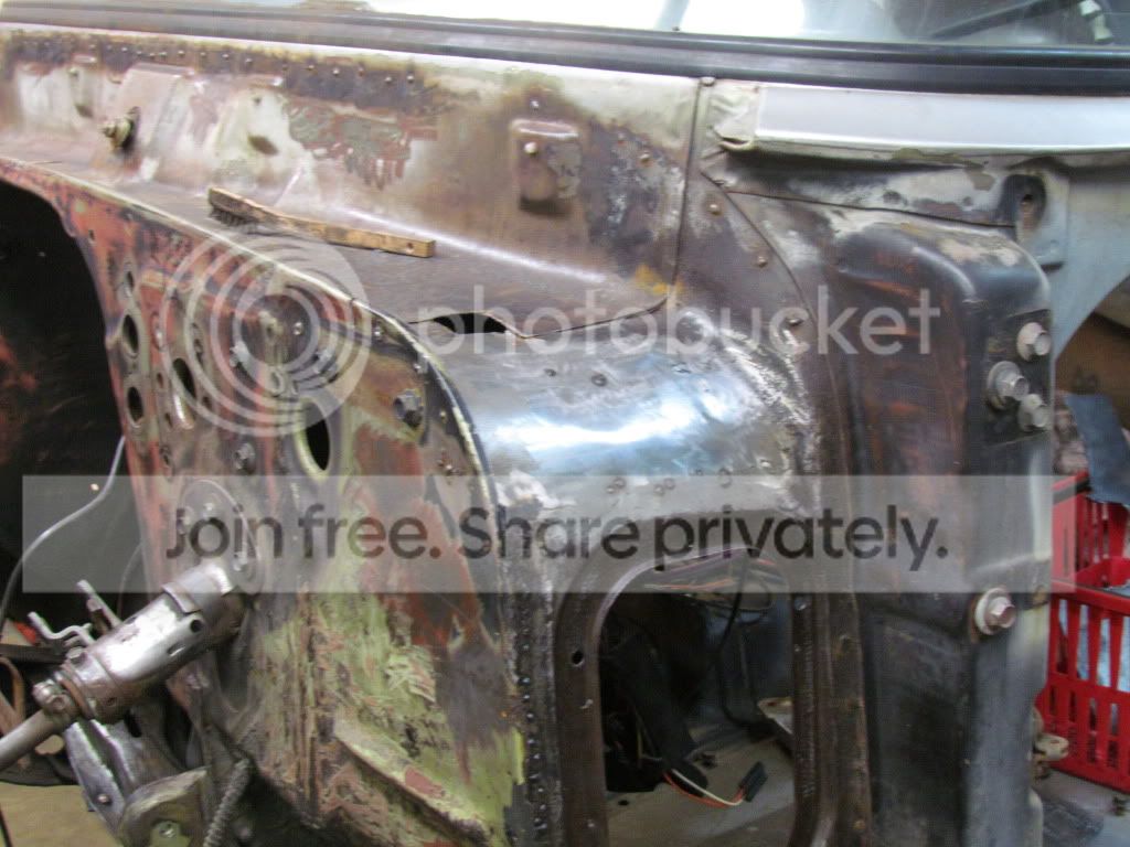

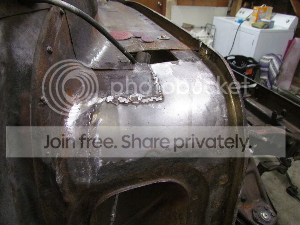

Here is the passenger side cowl.
Its hard to see the pitting in the weld. and those are stitch welds ground down.

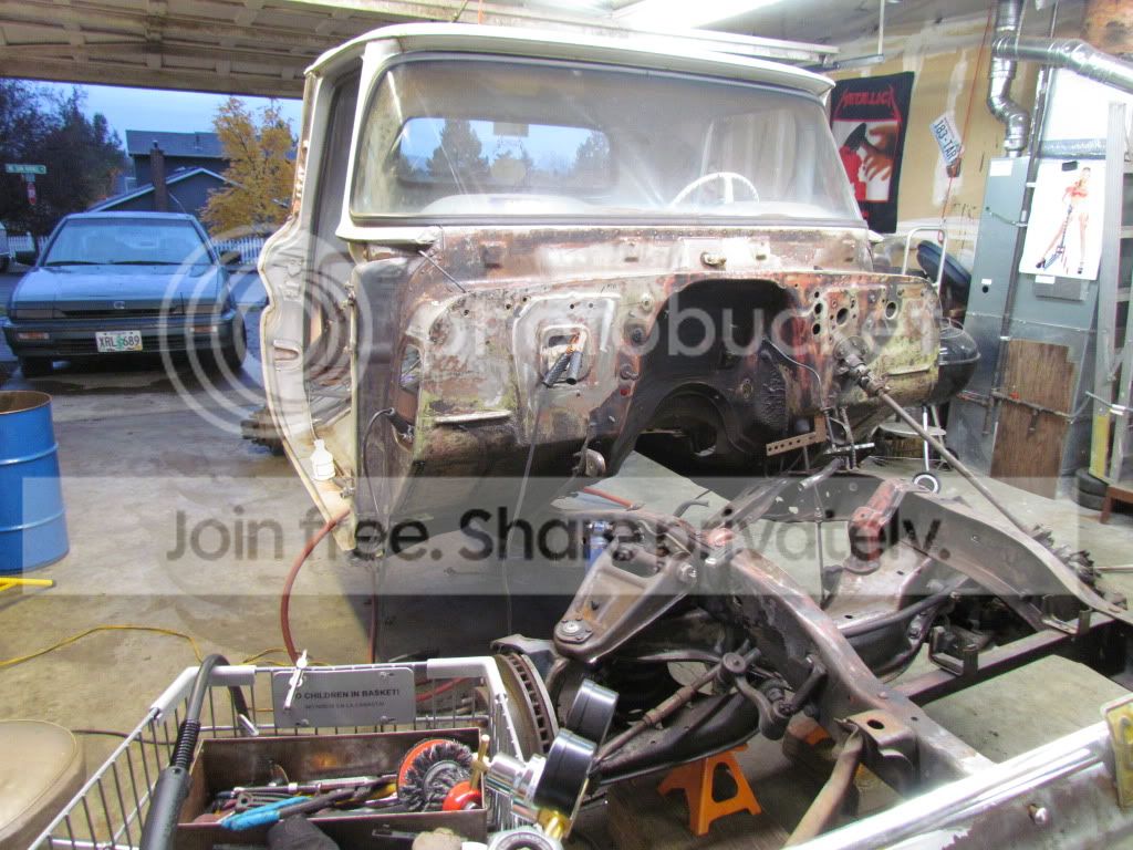

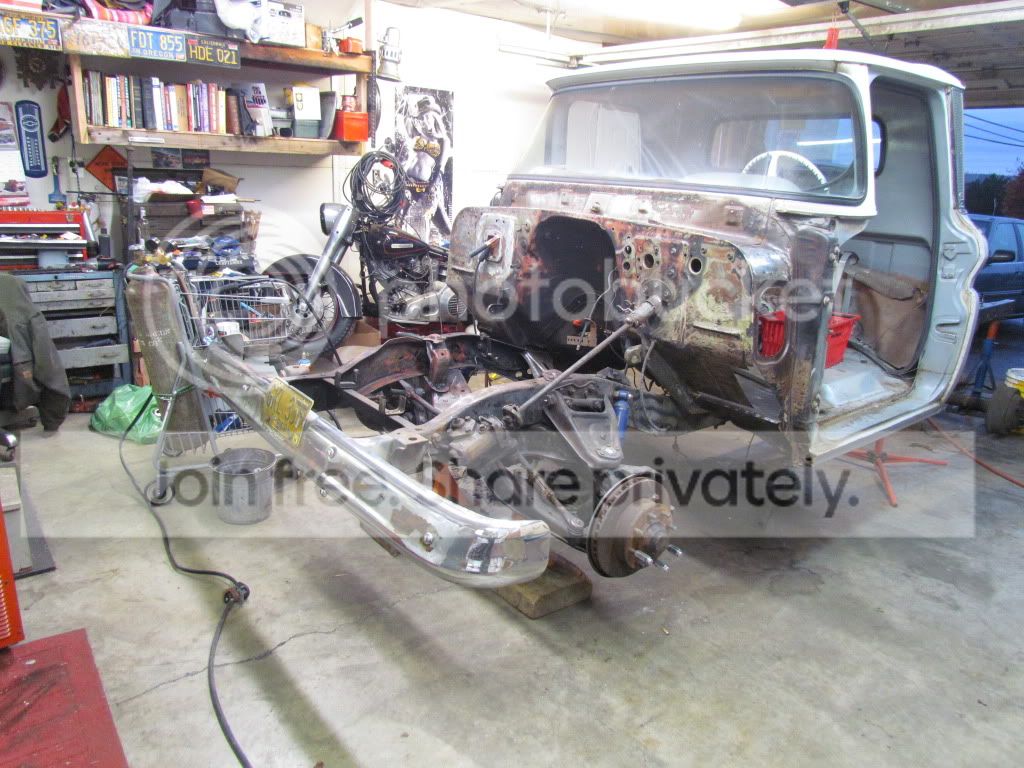

then a few showing state of the truck.

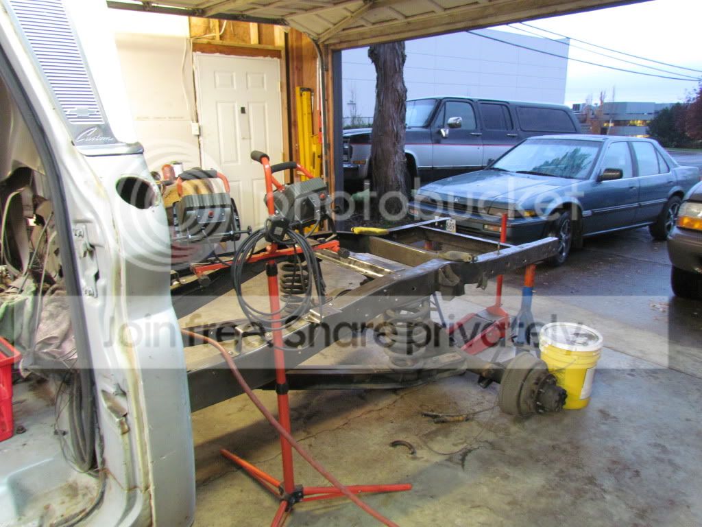

Got the other frame rail done and the rear end out i see! Good job!
EDIT: This is a cool pic!
Yeah never thought I would go this far bra!
The polarity is correct, picked up some .023 wire cleaned everything really good, and wouldn't you know it- it looks great now!
Thanks to everybody who responded, it all helped a lot!

If the windshield is good and plan on using it cover it up good and any other glass that's around.Grinding and welding will ruin glass if it lands on it.Nice project!
I run 30 psi on my miller DVI2 all the time. 22 gauge is like trying to weld toilet paper. Thinner wire will help. I would pulse weld it rather than trying to lay a continuous bead. Mess with your wire speed a bit. Like I said though 22 is gonna be tough no matter what ya do.
