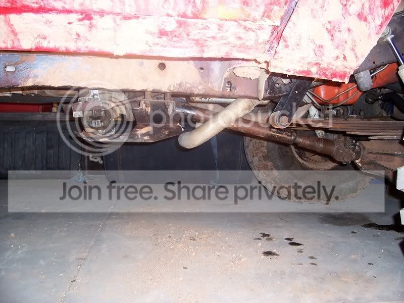

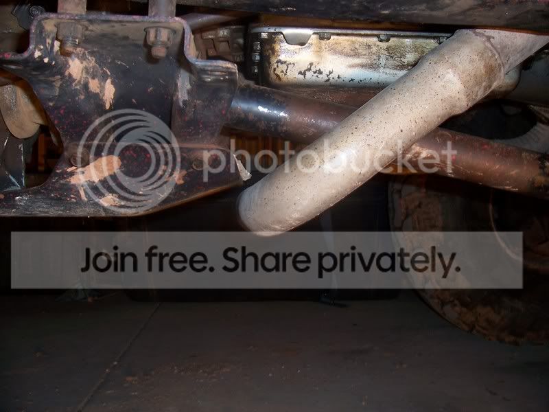

For the exhaust, I had to have mine routed down toward the bottom of the skid plate. Not a big deal though. I had a 6" lift as well. Can try to get a pic later if you want one.
I'd love to see a pic of how you have it routed. I need some ideas.

Here you go.
You can see whrer they cut the original exhaust off and put a lower crossover pipe on. It is not lifted as much now but had a 6' lift with this set up.
it's scary how much your k5 (stock) looked like my 82. apparently the previous owner swapped in an 85 grille on mine. so, i like your truck :D.
is there room to route the exhaust ABOVE the shaft. i've wanted to do that to mine for a while, so it's out of harm's way. eyeballing, it looks doable.
