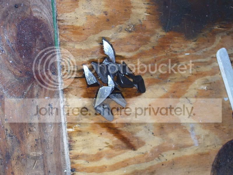

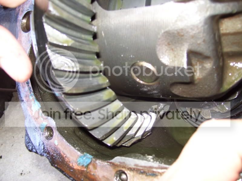

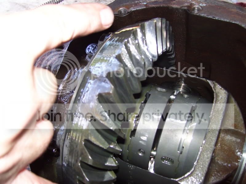

WElp here are the pictures...as promised. They really dont show how bad it is.:D
The pile of once ring gear...:eek1: :haha:
Correct me if I'm wrong, but does the gears show incorrect/off/wrong contact patch from yellow/green ink (or is that gear oil?) on the teeth?
Looks like Gear oil to me
It's gear oil...i prolly set the gears up wrong, (they came out of a junk rear) Thats why the shop is doing the next set.
I filled the ring gear for about 1inch with blue grease and the contact patch looked good to me. It meshed from about the middle of the gears all the way across.
O.K.
Would that show incorrect contact patch if that was the case?
Or, would that be (gear oil like in the pic) a reliable telltale sign?
