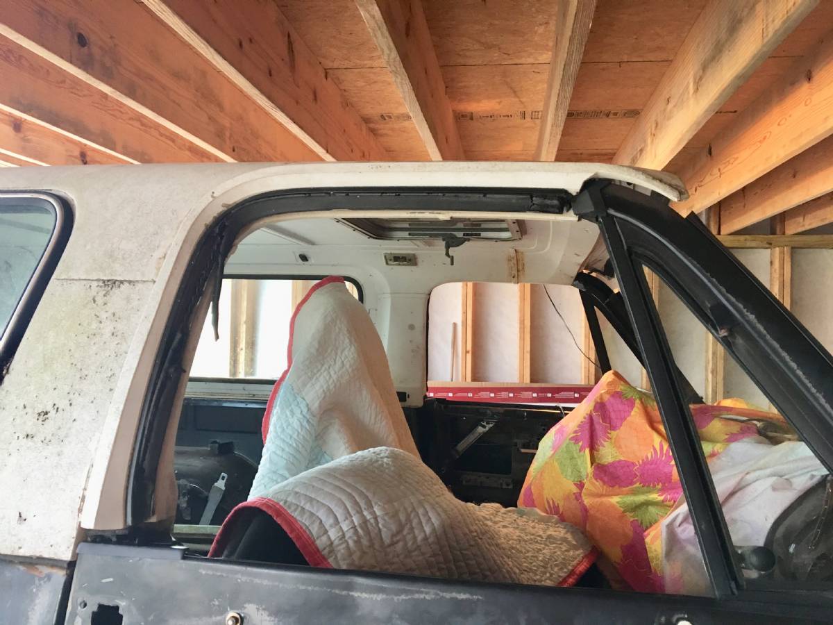

Well I did the deed! My Blazer is topless!

I'm not convinced that I have taken enough material off the top of the doors. They are tight where they seal against the top at the windshield area.
Better than taking too much. Both the doors on my 75 are cut down truck doors and they had about 1/8 to 1/4 too much taken off
Yes I’m aware. What I meant was that they are not the original blazer doors, and are uneven, badly. Thanks for your clarification on the matter

How does the rubber piece at the top of the door interface with top? Mine seems too tight
I'm also seeing some variation in the doors. Some are cut straight across all the way to the back and some retain a smidgen of the upturn
