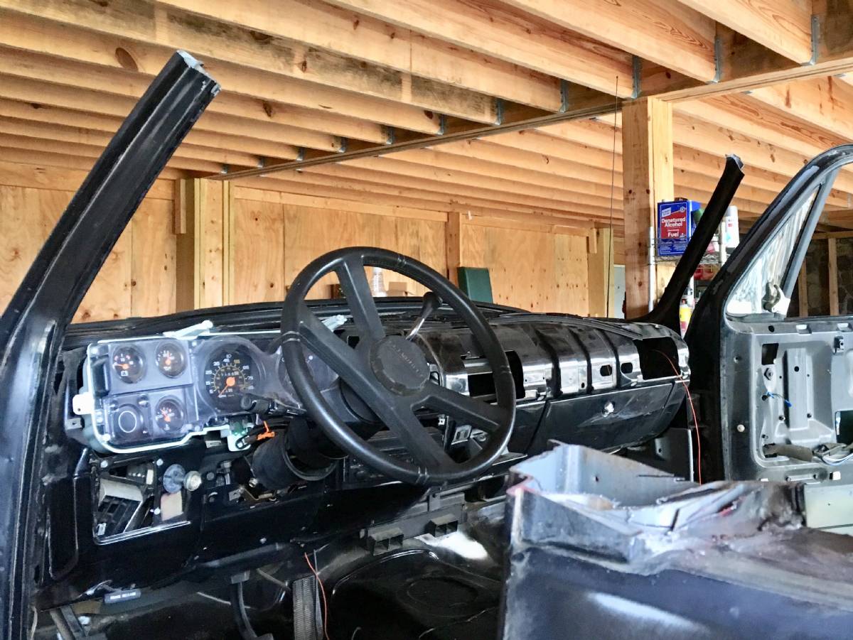

Well I did the deed! My Blazer is topless!

Lots more to do but I am confident in my team :smokin2:
Lookin good!

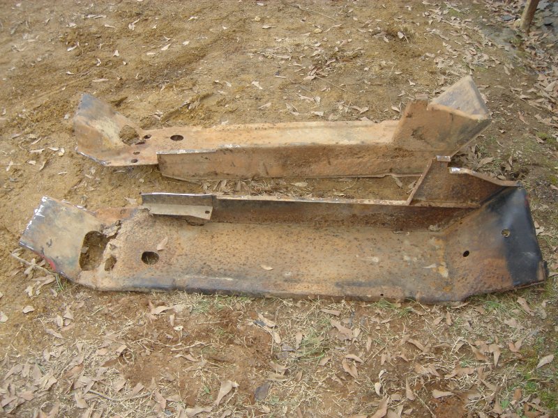

Are you doing any bracing to simulate rocker boxes?
Might want to consider installing the factory top close the tailgate and window. Close the doors and put the windows up to make sure all is lined up when you weld the header panel.
We did not cut the doors doors yet on purpose but we can't both install the top and close the doors. It is either one or the other. and I trust the doors more.
rocker boxes, cage or at least mini cage

I would really focus on the front cab mount to the firewall brace, it's the firewall that moves.
The vertical pieces forward of the body mount certainly make a difference. The problem isn’t the floor buckling, it’s the A and B pillars closing in and the doors no longer being able to close.
Yes and that flimsy rocker box with a big hole in it can't support the fire wall. There is not enough metal there. These things will just fold at the front. At best they stiffen the floor between the body mounts.
If it seems squirrely we will put some square tube along the inside of the rockers tying the front and rear cab mounts together.

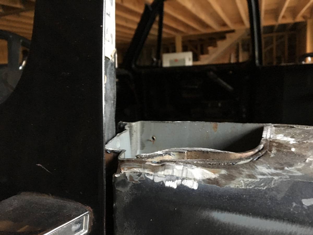

Got the other door pretty much complete. I may not have taken enough material off though, the tops of the doors are pretty tight on the top. Does anyone have reference pics?
