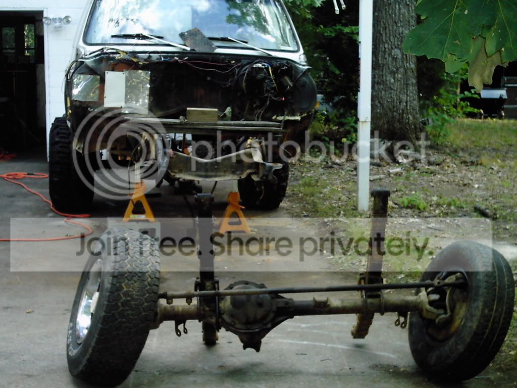

the truck when i brought it home-

here is how the truck sits today...

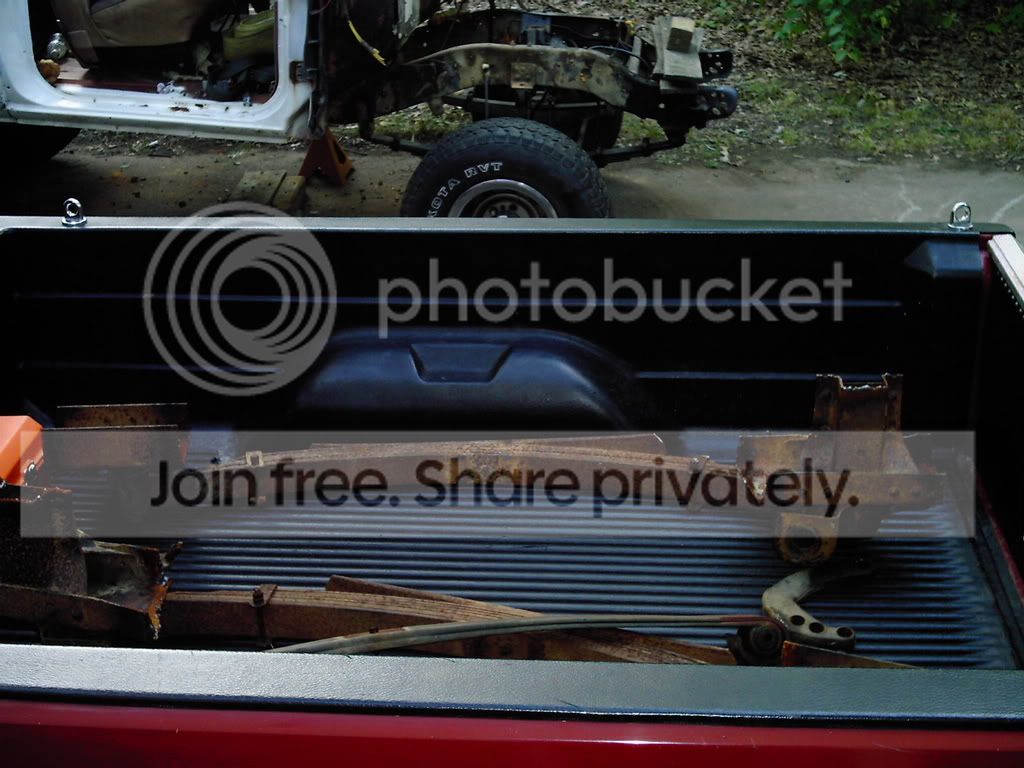

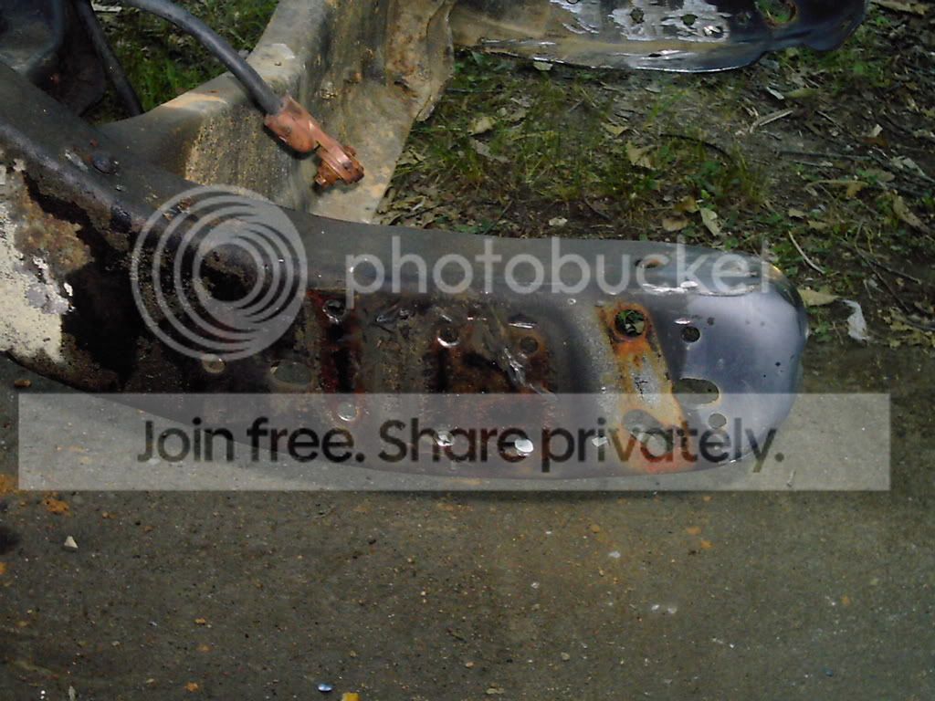

well i got some stuff done today....mostly some planing....i got the old 10 bolt and springs out and the stock hangers out....i havnt removed the rear mount yet cause im gonna get the front done first....im gonna start on the crossmember tomm and hopefully get it in....i also looked at what all is involved in putting in my weld in brace...oh and i got 2 sets of springs (52s and stock front springs)and a stocker steering arm all for 10 bucks...all in all a good day...anyway on to the pics

what do you need the cross member for? why not just move the hanger and keep moving? serious question in case you thought I was giving you a hard time. :rolleyes:

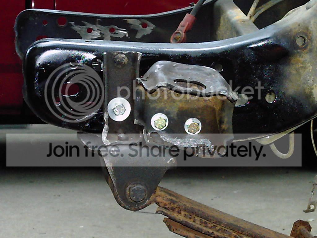

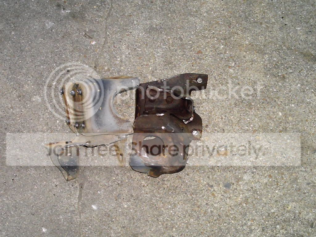

well i bent the $hit out of the body mount....i was gonna make a crossmember and replace the whole thing but i can get my hands on another set of the l-brackets so i might just run 2 and the lower mount....i dont need the body mount cause it will never see a set of fenders or grille again...:D
K.I.S.S. fenders and a rad support make it easy. if you bent it with a hammer you can bend it back. but if you are not going to use the rad mount I could use one.:wink1:
im not sure if im gonna use the radiator support or not...its all up to the guy making the cage....im gonna design somthing similar to kidjethro's truggy but the front will be all tube and tie into the cage in the inside of the truck...

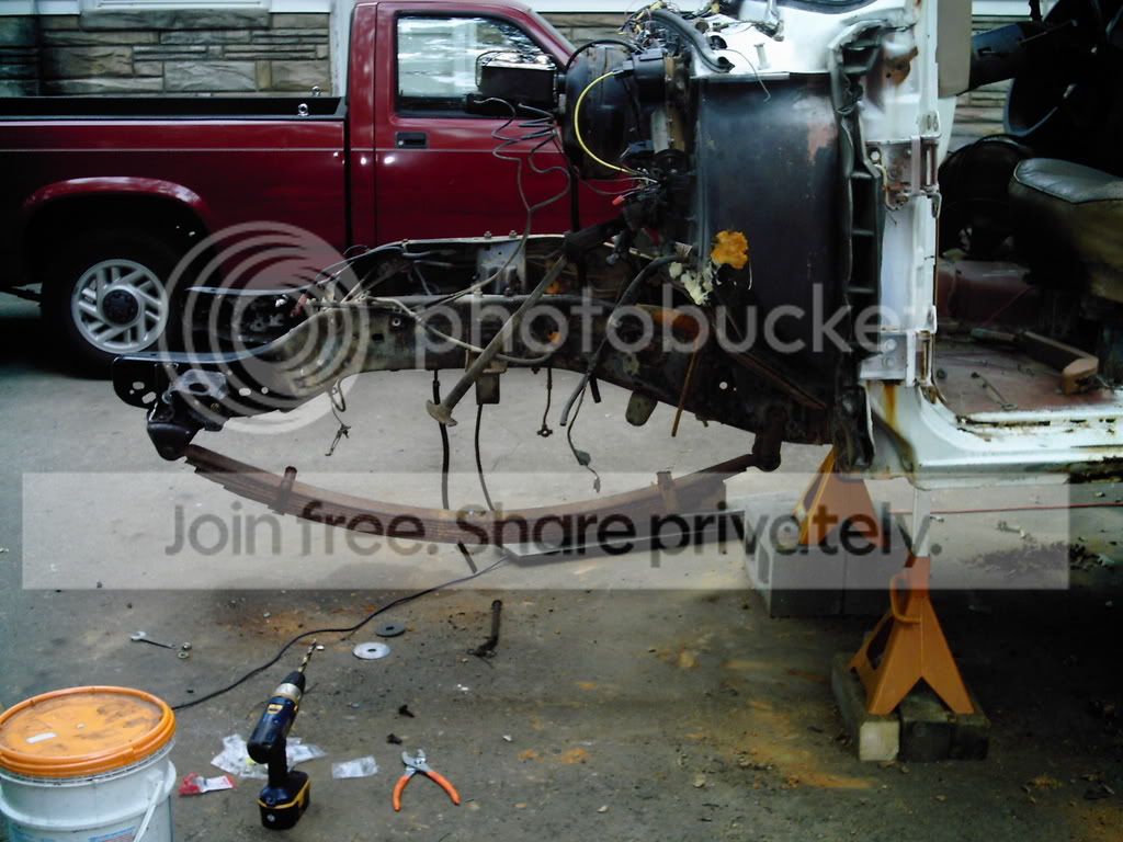

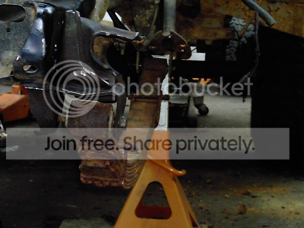

not to much progress today just got one of the 52s installed for the most part...the shackle angle aint the best but there is no weight on it too...i still have to put a longer set of shackles on it...anyway onto pics...oh and i did paint the springs and put more bolts in the hangers after i took the pics...
cant work on it tomm cause i have to work late but i plan to have the thing back on it tires by saterday...i hope..
good. my angle was worse then that with ORD shackles and the engine and front end. this is what I wheeled at Rausch.
keep in mind that your springs are at full droop right now minus the weight of the axle pulling down on it.
