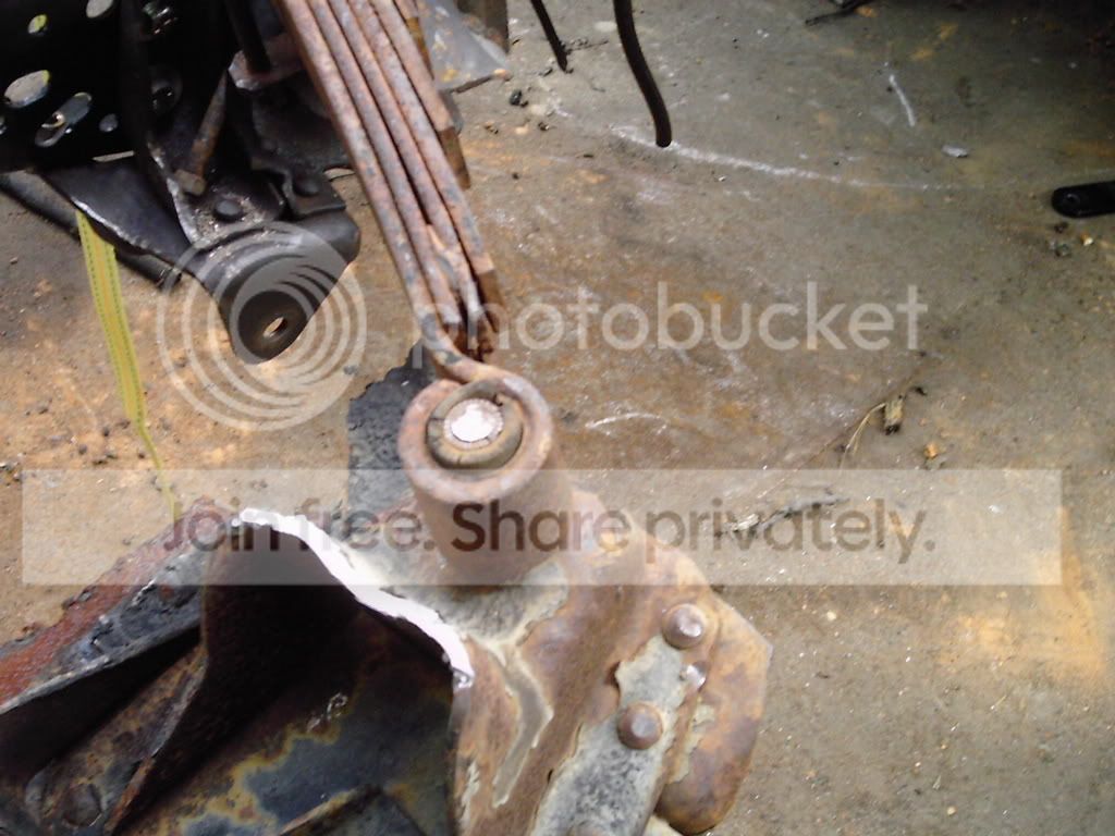

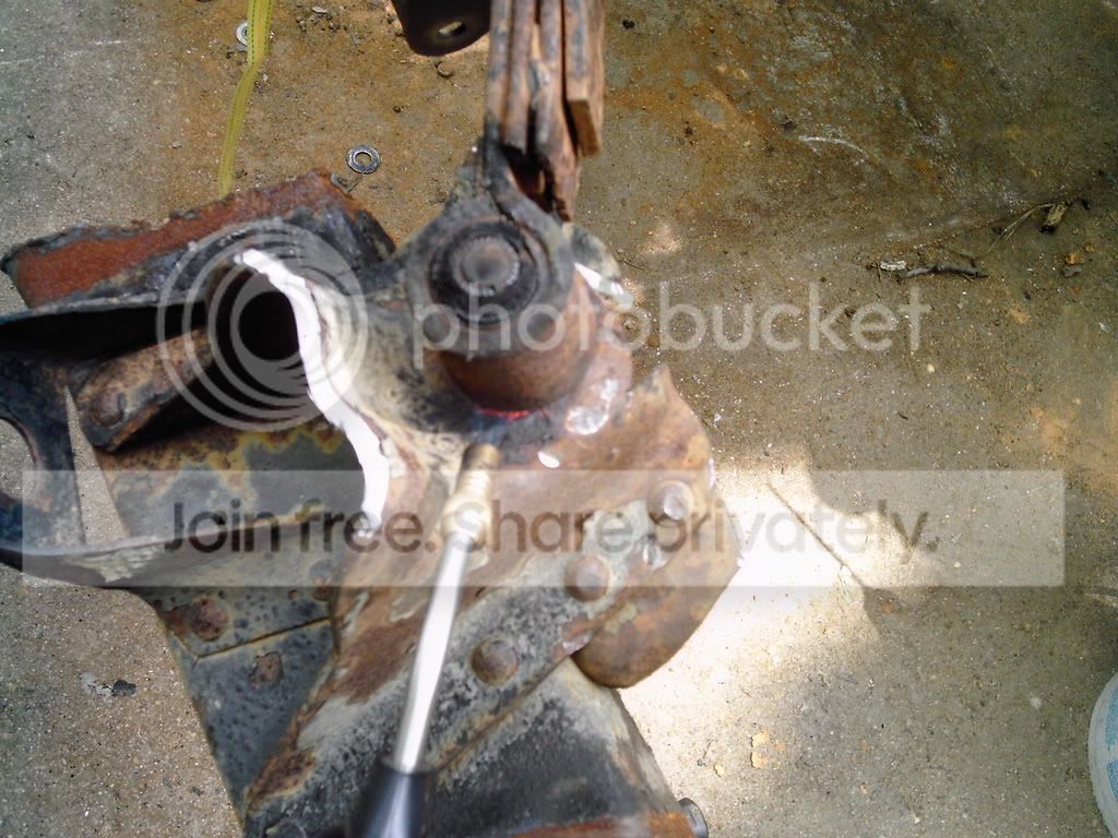

I got one side of the 52s done and in,the axle in place....could have gotten the other side done too but i fought for hours with a seized bolt in the bushing :mad:...so im gonna have to press the bushing out (no press) on monday at a buddies shop and get a new bushing...

stupid a$$ bolt

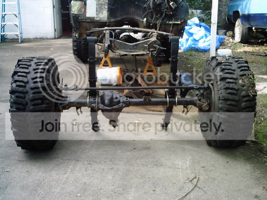

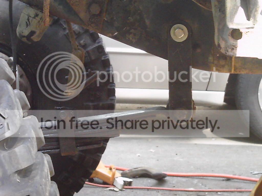

one side done
decent shackle angle now but there is not a motor or trans so hopefully it will be great once all that is in...

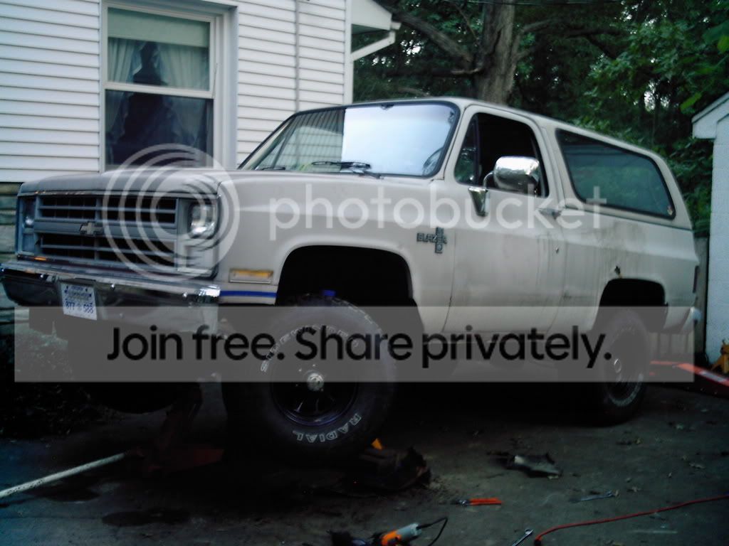

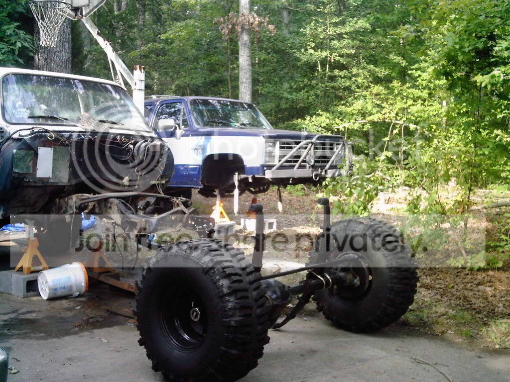

after some serous concideration i bought another blazer..i bought a 88 with tbi/ and a 700/208...this will save me a lot of money and time...i paid 1250 for the truck and drove it home...no work on it toady but hopefully next week i will have some pics up of some progress...
here is the truck...

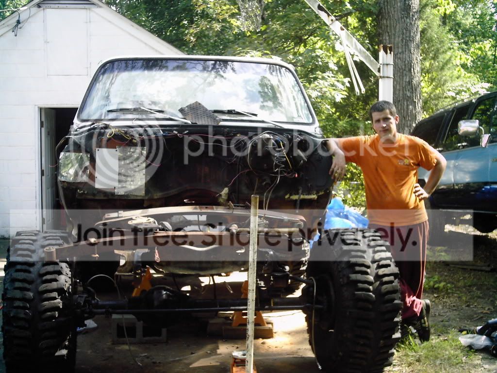

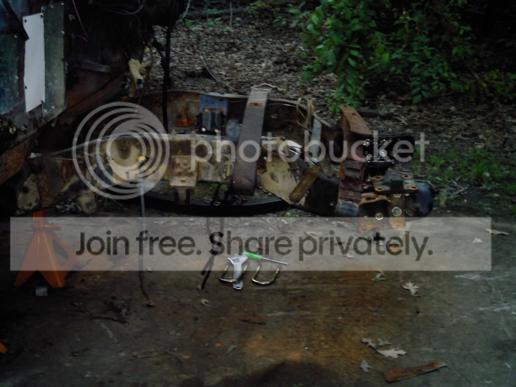

well today i got to work on the new rig....lots of rusted bolt :doah:....i tried going the no pb blaster way first but no luck....
i did get the axle out the other blazer (wasnt much to do there),got the shocks,drag link,and brake lines removed....also got one fender cut...im very happy with the way this fender turned out...i also cut the bumper...
hopefully tomm thing will go a lil easier with a full night soak of pb blaster...on with the pics..

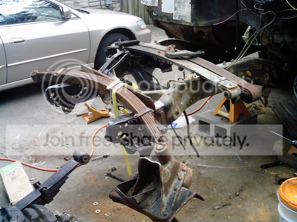

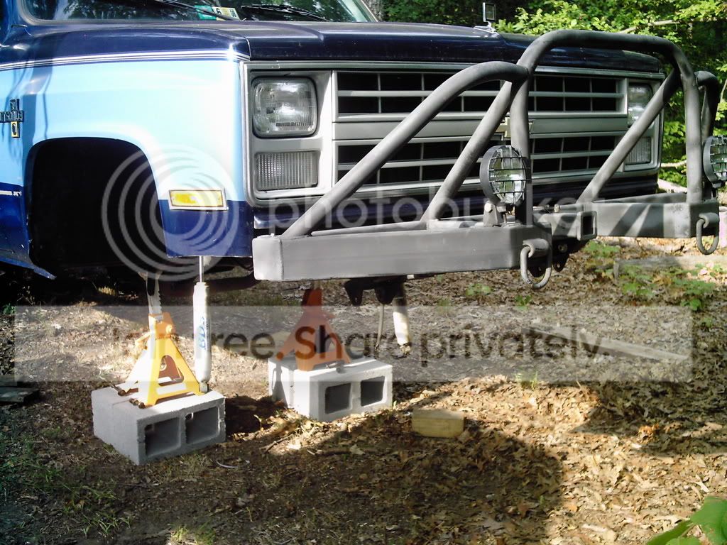

I looked through this entire thread and since nobody else said it, I'm going to. Why would you put yourself in such a dangerous situation by working on a truck sitting on concrete blocks? I'm not trying to be ugly but that is just stupid, and there is no other word for it. Spend less than $100.00 of that lift and tire money and get some correct height jackstands to put your vehicles on...don't stack concrete blocks!...it won't take but a collapse of just one of those concrete blocks and just by standing near the truck you would get seriously hurt. I don't mean to preach but when I see something that dangerous it needs to be pointed out. If you can't get the height you need from regular jackstands - safely build a larger base for the ones you have by using a wheel and welding the jackstand to it. It increases the height and also increases the width of the base of the jackstand.
the blocks arent stacked first off...second off you will se if you serch around on here long enough tons of people make a block or use concrete under there stands...ive been doing it for years...the stands i have are 1/2 the price of the huge ones thats why...mabye one day i will get some big ones but for now this is working fine...to each his own i guess...i just like moving axles with the tires still on them..im sure if you saw half the stuff i do you would think i was crazy and unsafe but i know my own limits...
well, just because other people do it dosn't make it right or safe - as to the "stacking" I was refering to stacking the jackstands on top of the blocks -
"mabye one day i will get some big ones but for now this is working fine"
I'm sorry you feel like this but maybe one day one of those blocks will collapse and there won't be any more days - that's what i would be worried about. Sorry I bothered.
