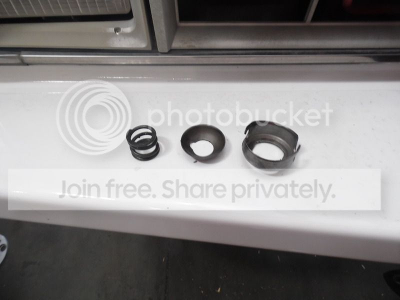

Waste of a day. My front brakes were screeching pretty bad, so I got some new pads and pulled the calipers off, the brakes on there look practically brand new. Must just be kinda squealy. Buttoned that back up and went to work on my sloppy shifter. I got the new parts in the mail with the stiffer spring, it didn't really help. Maybe a little. The problem is that stupid roll pin has a lot of slop in it. I pulled the 2 nylon rings out and put in some fatter o-rings, but didn't really make a difference. So I'm heading back home in not much better shape than I left. Oh well. Maybe another day I'll take the shifter back apart and just weld the two parts together and lose the roll pin.
