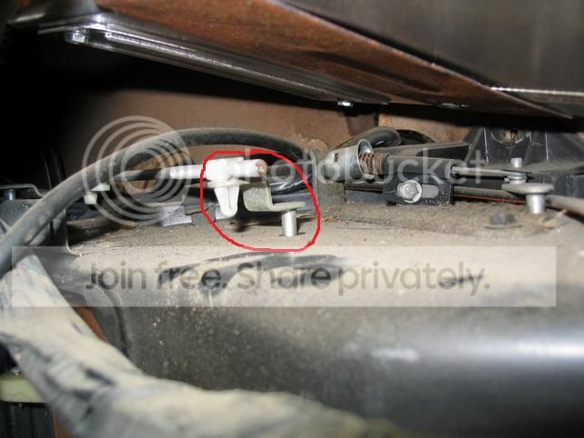

What A/C part is this?
jahmes143
Registered Member
Jun 19, 2014
8
FL
This is a pic behind the glove box (not of my K5). I need the red circled plastic bracket and metal swing arm (any any associated parts that are supposed to be inside the airbox). Mine are missing. Can't find it at local junk yard or on LMC or any GM diagrams. Anyone have a source for these parts? For K5 in sig.
I'm wrong, that part number is for the plastic clip that is on the A/C door itself, my bad.
The plastic clip in your picture should be the same as some door lock rod clips. I think they have them in the Motormite section at the local parts store. The metal arm and door will probably have to be taken from a junk yard.
One is the temp control and the other is the blend door. I need to fix mine the place that did the heater core screwed it all up. I now have vent flow when in heater and Defrost. Also I used a aluminum heater core and the heat temp is no where near what it was before. Be sure to mark where each cable rod is before you remove them!!!
