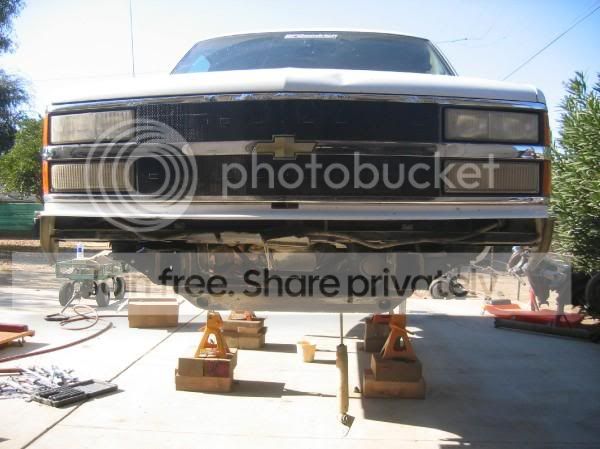

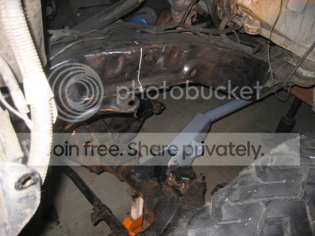

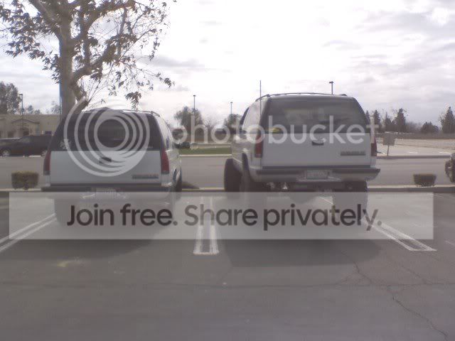

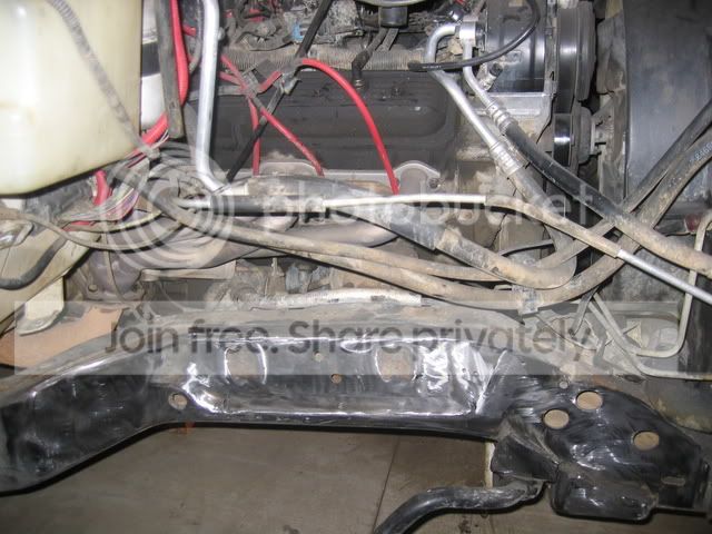

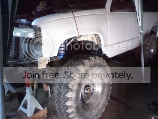

SAS COMPLETE!
still need front 4.88s and ft driveshaft. doing a build thread for 2doortech.com so I'll probably copy and paste it over here when I get around to doing it in the next few weeks.
I guess I never posted any
previously :confused: <-- what a lazy SOB

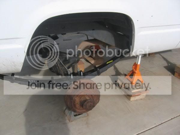

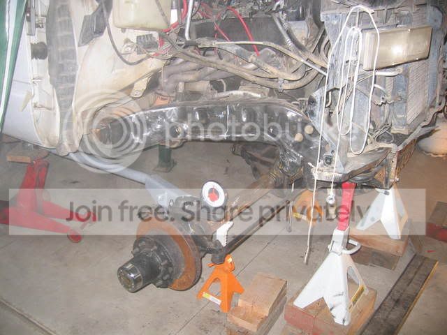

I have GOOD pics from removing
all the IFS junk and the early phases
of building the new front suspension.
At that point I lost my camera though
so I had to rely on the 1.3 megapixel
camera phone. heres some pics to
summarize the build until then:

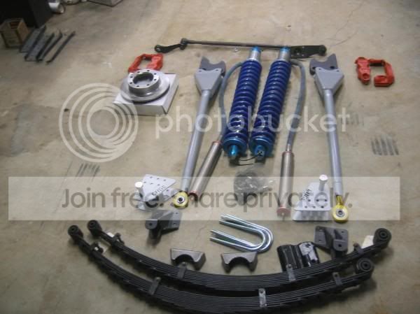

Parts shot
IFS GONE!
rear end being set up

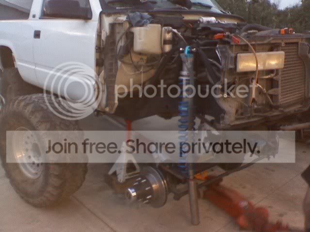

front end going in
frame cleaned up
arms

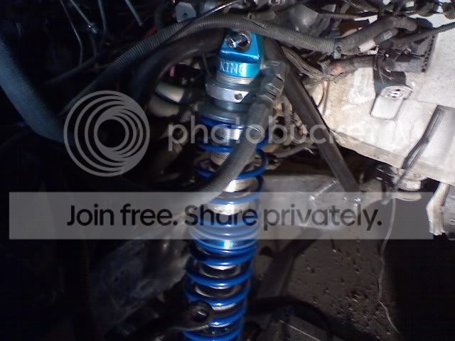

coilover set up
mock up for ride height

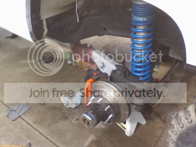

new rotors, calipers, lugs
cycling suspension and adjusting the coilover
finished product (minus front gears and driveshaft, frt bumper, etc.)
:D self explanatory
