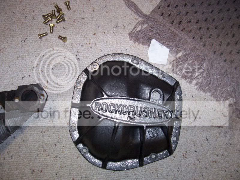

I bought a rockcrusher for the front 60 for 70 shipped and got it today and painted it, seems strong but not quite as beefy as I thought it would be
