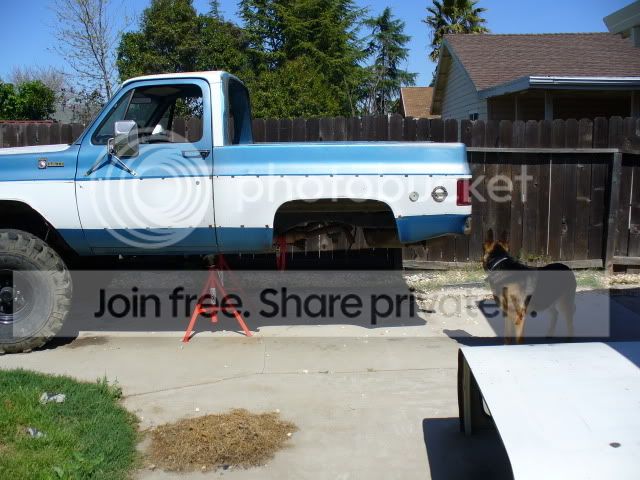

Here you can see the jack stands I use. I picked these up at a local swap meet for like $20. They really come in handy!
