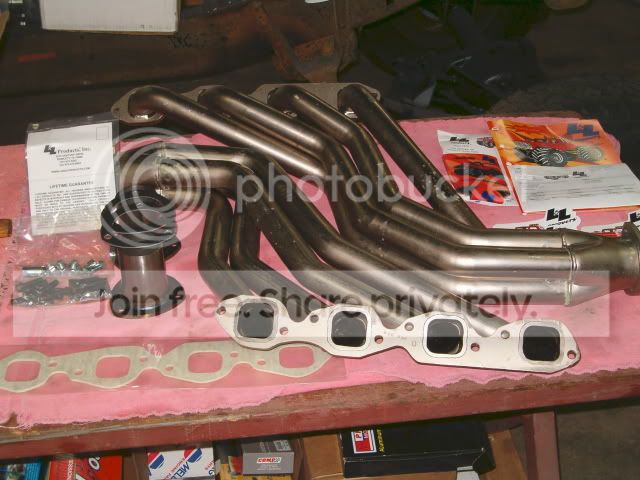

L&L products; they make em for SBC too:
see about the fitment here:
http://coloradok5.com/forums/showthread.php?t=261694&highlight=76zimmer&page=12
post 558

I'm buying L & L's too.. again pricey, but pretty bomb-proof #'s.....
