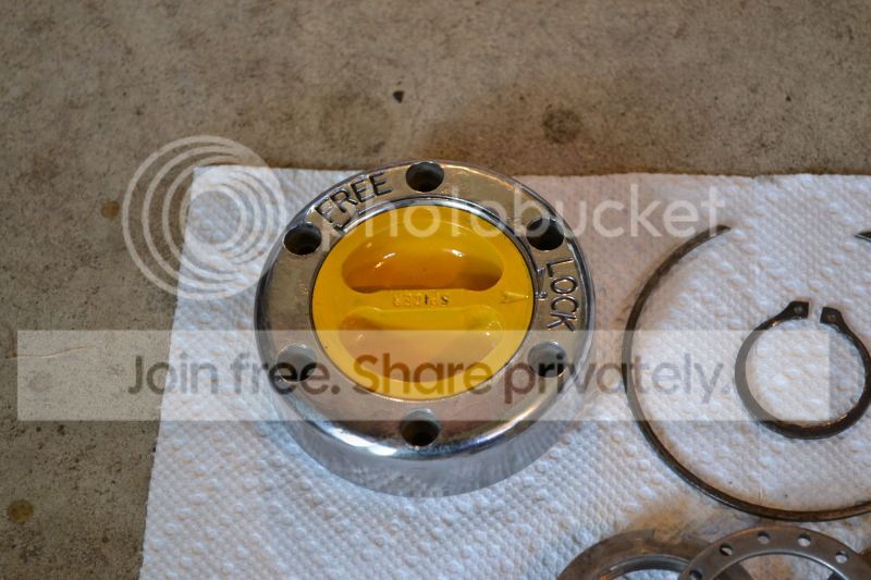

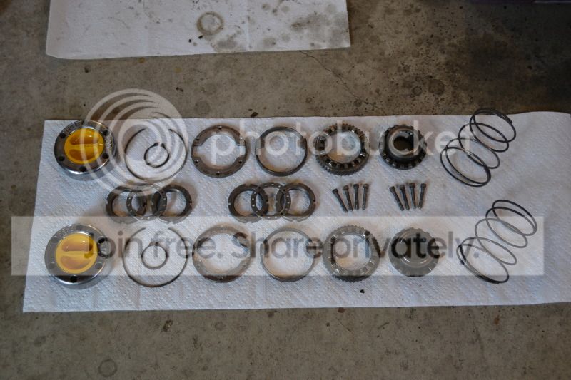

What hubs are these?
SafetyHelmet
Registered Member
Oct 7, 2013
87
Minneapolis, MN
I haven't been able to find more info online- can someone tell me what model/type hubs these are? Obviously they're Warn, but I haven't had luck at identifying why the Premiums I got won't fit. I want to install some Warn Premiums that supposedly should fit, but unless I can do away with the hub body they came with, I'm not sure how that's going to happen!
They are warn premiums for a mid 70's Dana 44 with external hubs. If you have a 10 bolt or 1/2 ton Dana 44 in a Chevy, you need internal hubs.
yep mid 70's and older . dana 44 stuff.
need to remove the bolts in the back to get the rest of the hub off.
and warn reg to prem is not much better in my opinion . and on these for sure.
Take a trip to the junkyard and find an internal hub truck, the hub will be held on by tiny allen bolts. Get the hub and spindle if its the larger bearing size. and get a set of spicer lockouts, and you will have the strongest axle gm used other than the dana 60. Warn hubs are junk IMO, pot metal. The spicers are all hardened steel
