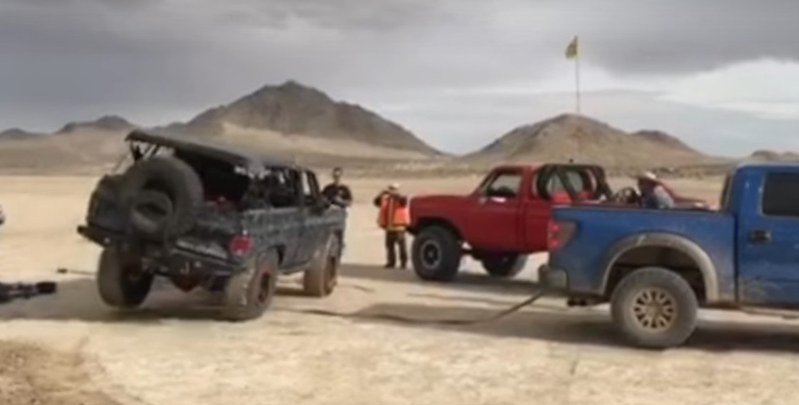

Whatever is eventually found, I bet the damage was done during recovery more than the actual roll itself.
I don’t care who you are…..that is a hard landing! I’d be looking real hard at the passenger’s side rear spring pack
And Merrick….dude, WTF? If all things in the world to pull your beast back on its wheels why in the world film a Ford Raptor of all things when there is a cherry old Chevy right there to help a brother out! :haha:
for real. I was so stoked on that square but the raptor was willing to help and the square guy wanted to just stand around. He is the one in the orange vest shooting video.
Yea, it was a hard hit, there wasn't any other way of doing it. I was actually impressed by how well it handled it.
That is a good point though. I have spent all my time focused on the side it rolled on whereas the passenger side took a lot of force.
On the good note, apart from the steering wheel clocked weird and the strange rattle thunk clud, it drives like new again. tracks straight and true down the freeway even at 80 mph +
