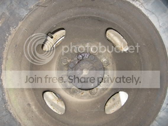

Get a good pic of the hub's and it might help identify if it came , originally, from a GM .
Tom

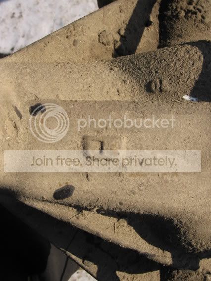

well it says 70 on the casting and the hubs look kinda like a 14bff.
i want to run hummer wheels so if it is a 70 would it match up to the duelly front 60 that i have?:confused:
It is most definetely a Dana 70 "B" series axle not a 60 or an 80 . The webbing and big "B" casted on the top of the pinion oiling channel is a dead give away.

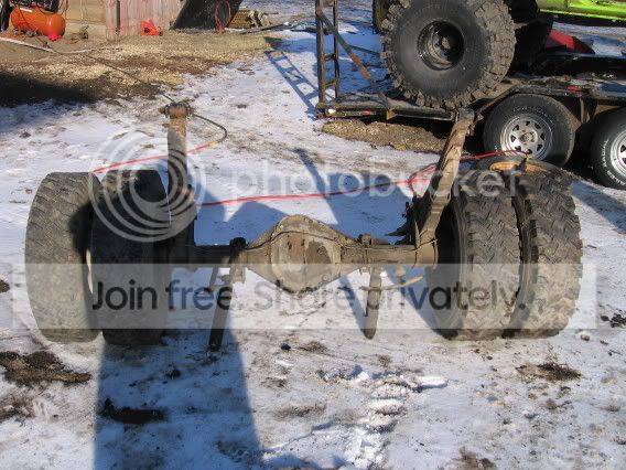

Did you see the truck it came out of ?
The hub does look like the standard GM offering but that particular series axle usually was not used in the C/K trucks - could it have come out of a Van ?

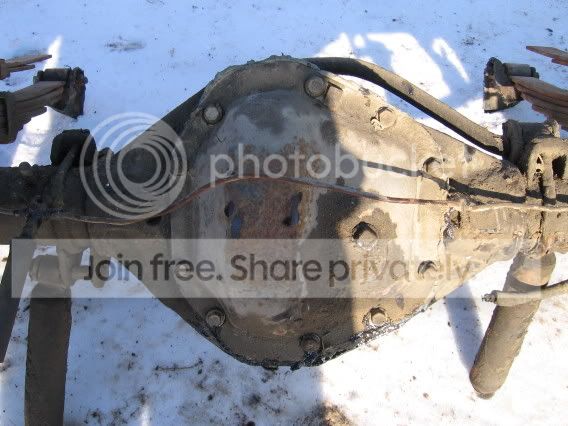

The pic of that rear end has different style springs than what would have come on a late seventy's erra P/U - most trucks used a thick , long over load bottom spring and the rear in that picture has progressively shorter springs all the way down.
Look on the passenger side back axle tube for a B.O.M. # it should be six digits a dash and than another digit all numerical. The B.O.M. number will tell all .
Tom

The rear axle that most GM folks want ( to run Hummer wheels ) is the C/K dually H.D. 70 axle or the G series Van Dana 70 "B" series axle ( it is wide but I can not remember how wide ) and I believe the axle in your pic's is a Van Cab Chassis Dana 70 not the H.D. models that came in the trucks.

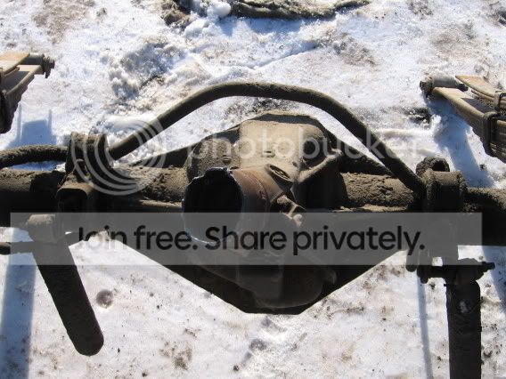

i'm not shure what this came out of but the rear that was in the truck that i got my front is still around. however it had a bolt on yolk like a 14bff, but i thought that the rear i would need would be a 70 like this one? help i'm lost
