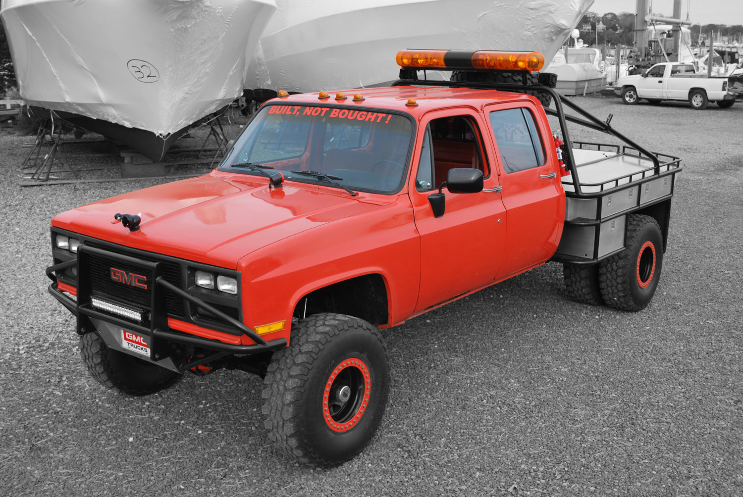

for single stage, duponts Nason is a good economical line.. I run a custom mix on Mutt.... while it's no Glasurit, it's good for the coin...... ANY metallic really needs to be done in base/clear.. foolish shooting that in single stage in this day and age....

Thanks for the recommendation, probably go with the Nason, I've heard a couple others suggest that. Nice truck by the way, read alot of your post and most of your build thread.
