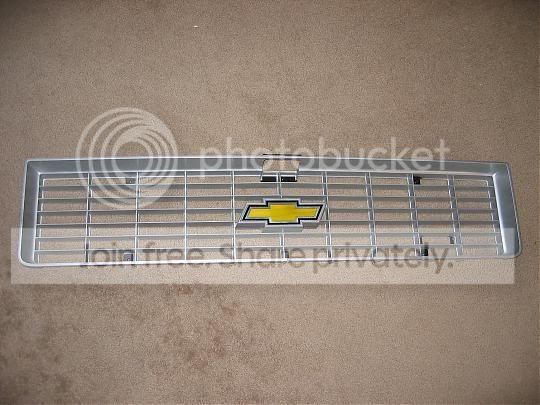

OK, a little pic-whoring on my part here:
First, what you can get off Ebay. (and maybe a good color ref Craig?)

WOW :eek1: . I'm drooling over that NOS grille. I'm starting a favorite search on eBay right now. Heck I'd settle for just a new gold bowtie applique to replace my old, faded one. If you ever sell your Blazer (which I doubt you will), I would love to make a deal for that :D . I saved all those pictures to my computer for color reference. That will be a big help :waytogo: .

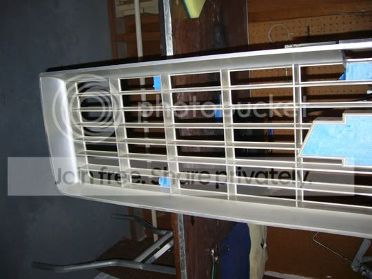

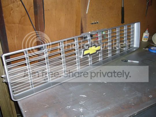

Well I got my grille all painted over the past 3 days. I nailed the argent silver on the grille part. For anyone who wants to know, GM Rally Wheel Argent Silver is the same color as your GM grille.
The only thing that didn't come out perfect (and I didn't expect it to) was the bowtie. In the pictures it looks like I just shot it with yellow paint. I actually only dusted it with yellow Krylon to bring back some of the original yellow. I could not fully preserve the "prismatic" effect seen in Ben's mint condition NOS grille. But overall I'm pleased with the result. The grille now matches the condition of the rest of my truck.
And some before pictures...
