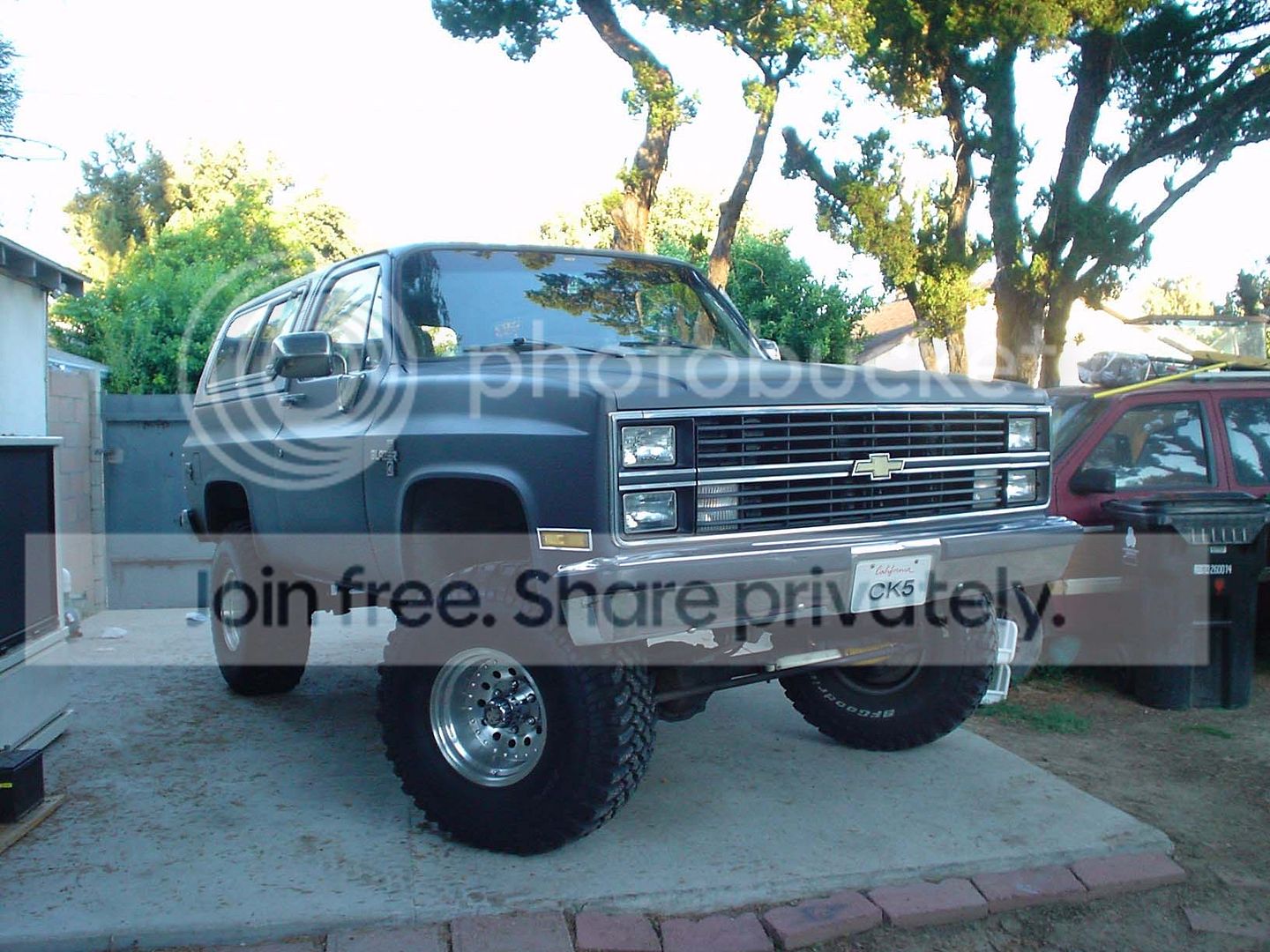

Here some grill options
The first one is like my 83
