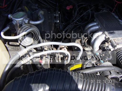

I switched from V belt to serpentine. My AC is now on the passenger side. I'm trying to buy a new AC hose for the compressor, part 9 in the picture, with compressor #5. My old setup came off my 85, so it's not #32-0726. Which part number do I need that represents the picture. This is exactly what I need.
I did the same thing. I'm going to order a hose assy for a 89-91...#32-0729 is what you need. I don't know about the compressor you need. If my 86 doesn't work, I'll get a 89 Sanden. fwiw, I already swapped mine to r134....

I'm going through this right now. I ordered an 89-91 hose, but all of the parts stores I looked at stock the same hose as my stock 85 one:
getimage.php
The short answer is that none of the parts stores carry the A/C hoses for 89-91 square nose (gas) unless you have rear A/C. AC Delco is the only thing on the market.
With the compressor on the right, I worked over my stock lines with a conduit bender to get everything connected, but the return line still has a bit of a twist to it. It looks silly with such long hardlines coming up out of the compressor and stretching about a foot towards the coolant overflow tank. They need to go down from the compressor.
I tried the Camaro lines - the small hose reaches the condenser perfectly, but the large one is too short and bent wrong to reach the accumulator.
The pickup-truck lines have a bend to reach the condenser, whereas the square-nose condenser requires a straight shot here.

the first pic looks like the hose in my diesel (90)...I can't locate a unit for one with rear a/c, only without.
on my 86 I swapped in a serpentine rig, using a hose for an 89 5.7 rig...:waytogo:
This is what the DS compressor lines look like with the compressor on the PS. They kind of push against the battery in a big loop. I had to bend the complex hard line off the evap to move that whole thing back and do a lot of bending on the hardlines coming off the compressor.

I don't know, wasn't there a pic in the first post...?
looking up the part #, it looks like you got the right one...

Found one that fits right.
Kind of an update on an old post:
Both the ACDelco 15-3867 and the 15641231 GM part are discontinued. I searched high and low and used the interchange at one of the dealerships I work for and found NONE. So I went to the local GM distribution warehouse and opened 50+ hoses to find one that works.
The ACDelco number is 15-30182. The universal number is 55852. The hose needs a small amount of tweaking to be perfect but its a great fix. It was originally used on 1993 GM trucks with 5.7L with passenger side R4 compressor. It fits the original condenser and accumulator.
