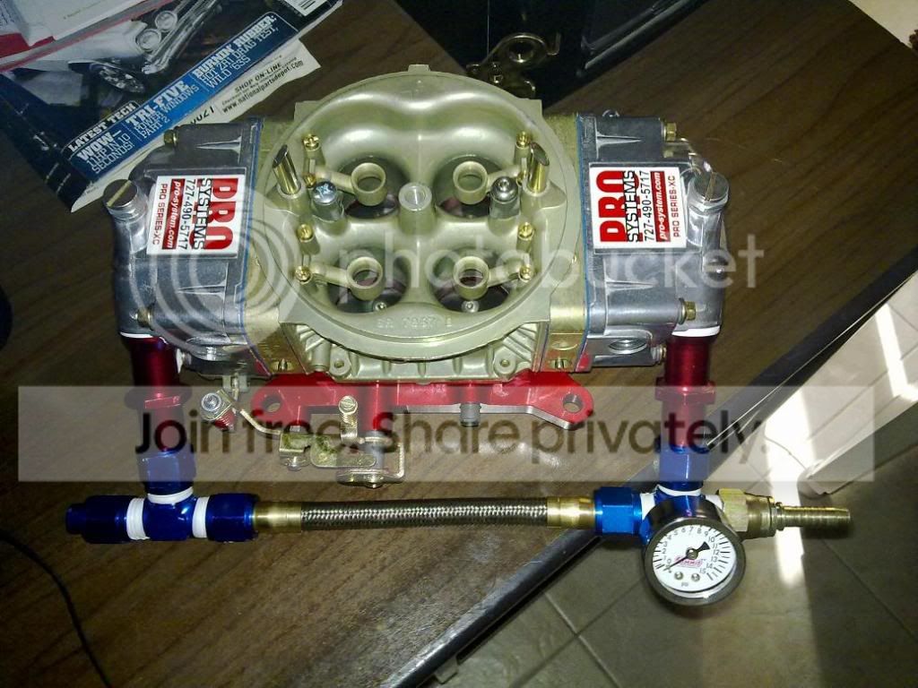

I am using Pro-Systems built 950 HP carb
and it runs flawlessly
I've used Edeljunk 1407 750cfm previously and it won't stay in tune and it doesn't like bumpy roads in the desert
I've also used a stock Q-Jet ( on a stock 355 SBC ) it was OK but when I upgraded to a mild 454 BBC I went with Pro-Systems based on JDNobodi advice

Have you side hilled this carb in the dunes at all? How much did it run?

driving in any angle is perfect
I've let it idle for a long time on a hill and it was OK also
I didn't test it idling on a side hill though
I paid $690 for mine
check with Patrick @ Pro-Systems for pricing he is a really nice guy
you might buy used Holley 4150 core from E-Bay and let him build it for you
