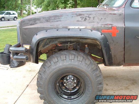

Here is 4" and a 35" bfg mt. Got some room in the back but the front rubs going up and down driveways. 3.5" bs on a 10" wide wheel. 4.5" wheels only rubbed on the trail and not the street.

is there a lip under the front section? i know on my year others cut it off so I did it a few years back.. gain a few inches up...
let me see if i have pics to explain what im sayin
not the same angle so stock one doesnt look the same.. but look at the gap between the tire and fender....
stock fender
cut flare and fender...
lip?
Not exactly sure what your talking about RB, but here are a couple of pictures. I guess the "fang" curls under towards the frame which could be removed, without changing the look to much.
