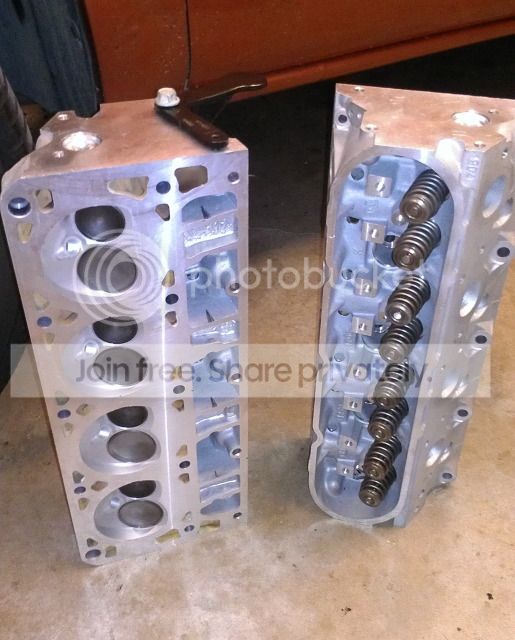

This is an all new engine for me at the moment, learning as I go, these were the stock heads that were on it, they just cleaned them up and replaced anything that needed it.
I'm sure they probably checked them for cracks then. But, from what I have seen, the 706 heads were produced by two companys. Castech and some one else. The Castech heads have a tendency to crack around one of Tue bolt holes and it let's water seep up under the bolt head.
Yeah, they did the full on rebuild & checked everything on them, I will look for that little symbol when I get home.

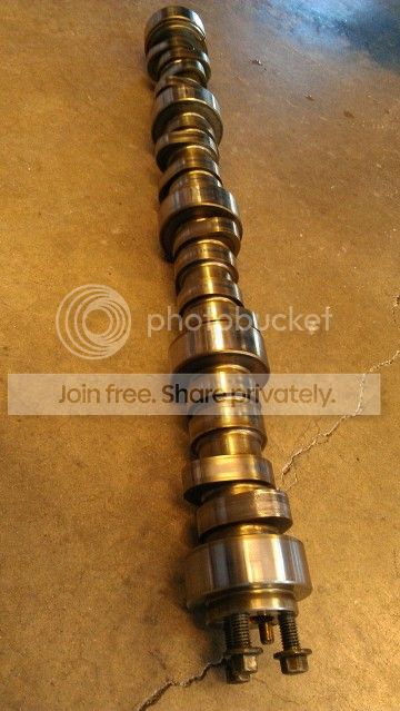

But, going back and listening to the sound, and looking at the damage again, I still say that the lifter looks like impact damage.
Unless it just started spalling under load.
It really sounds to me like there was something binding slightly and not letting the lifter follow the cam fast enough.
That would explain the pinging/knocking sound you heard. If the lifter was floating off the cam as it dropped down and getting slammed by it when the lobe came back up.
After the roller got chipped, it would do the scarring you see on the cam. Probably stopping from time to time on a damaged spot and just sliding along.
I can't think of much that would cause that that would not get fixed in a rebuild. Broken valve spring would have been obvious. But a slightly bent valve stem, or some varnish buildup on a valve guide that let it bind slightly when it warmed up might not.
Actually the bent valve stem would have shown up when it was pulled due to the wear pattern on the stem.
Whatever it was, if it was letting the lifter not return fast enough, it had to be subtle, because otherwise you would have heard a skip or seen a burnt valve.
I don't remember, was it on an intake or exhaust valve?

Just went and looked, it was an intake valve...#1 cylinder
I think you may be on to someting with this idea, I will admit that there were a few times, while on the throttle heavily, not anything that should have caused any issue, but nonetheless, I could hear either pinging or what sounded like valve rattle from time to time.
I am wondering if the valves weren't bouncing at higher rpm's, maybe need a tighter spring or something, I dunno. I was doing some research and saw some people commenting about lifter chatter or something, like the roller doesn't get to roll over the cam smooth, it sort of bounces. It's usually visable apparently during tear down for any other reason.
I inspected all other roller tips on the lifters, none were horribly worn, but most had some sort of small line on them. Nothing you could really feel, but just barely visable, one was very visable, I believe that was the one opposite intake #2 cylinder.
Either way, they are all getting replaced, and I believe I'm going to pull a rod cap or two for a quick inspection tomorrow during other clean up stuff and whatever I can do to prepare for reassembly.
