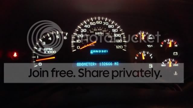

Well, got everything hooked up, connected the battery,,, nothing.... Dead,,, not sure why, It's fairly new, cables were unhooked, been down what, a month?
Anyways, got it jump started because the little standard charger just wasn't doin it
Runs good, took it a bit to relearn everything, really interesting listening to the computer work things over. Test drove it, again it had to relearn the way it was going to run while driving. Got it back home, sounded awesome, nice smooth, quiet idle.
