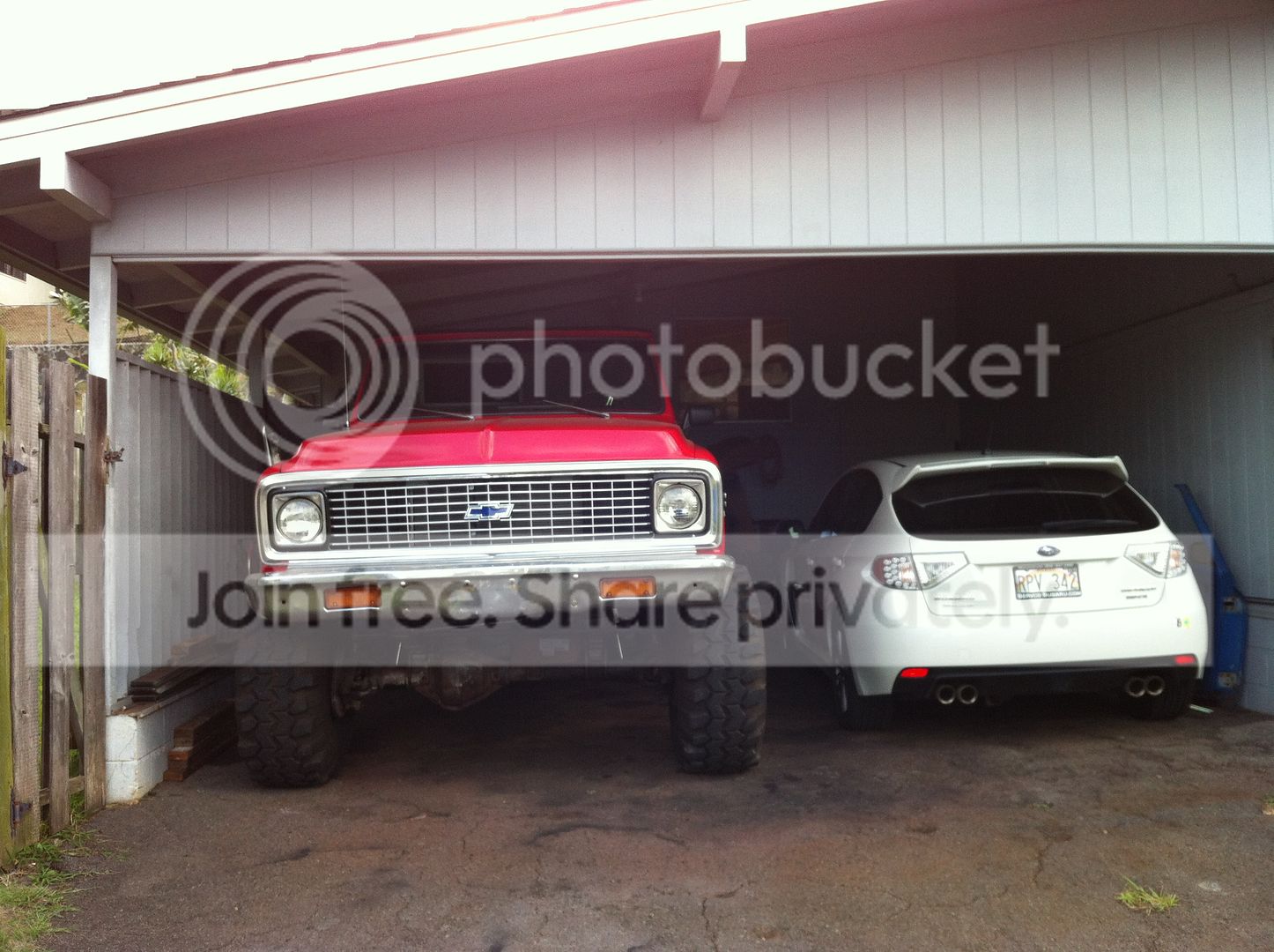

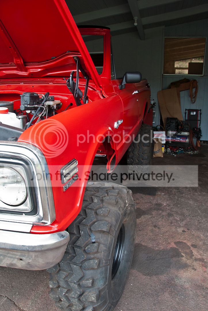

D Dabbas 1/2 ton status Joined Sep 25, 2011 Posts 165 Reaction score 0 Location Jordan Feb 13, 2012 #1 Guy anybody have 15x10 2.5 BS ? Show pic plz
Z71paramedic Wait....What??? Premium GMOTM Winner Joined Sep 27, 2007 Posts 4,291 Reaction score 539 Location Lakewood, WA Feb 13, 2012 #2
D Dabbas 1/2 ton status Joined Sep 25, 2011 Posts 165 Reaction score 0 Location Jordan Feb 13, 2012 #3 Damnn truck man!! Keep it up!
Z71paramedic Wait....What??? Premium GMOTM Winner Joined Sep 27, 2007 Posts 4,291 Reaction score 539 Location Lakewood, WA Feb 13, 2012 #4 Thanks dude
D Dabbas 1/2 ton status Joined Sep 25, 2011 Posts 165 Reaction score 0 Location Jordan Feb 13, 2012 #5 Is that dana 60? If yes did u grind any thing in the break to fit the wheel?
Z71paramedic Wait....What??? Premium GMOTM Winner Joined Sep 27, 2007 Posts 4,291 Reaction score 539 Location Lakewood, WA Feb 13, 2012 #6 Yep it's a 60. No, no grinding necessary with those rims. They clear just fine, but stick out a bit as you can see

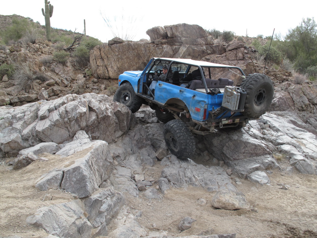

r3dd0g 1/2 ton status Premium GMOTM Winner Joined Sep 14, 2006 Posts 3,309 Reaction score 7,463 Location Chandler, AZ Feb 13, 2012 #10 My old rims were 15x10 with 2.5" backspacing and DIY4X rim strengtheners. I did have to grind my dodge D60 calipers a little to get them to clear, but not much.
