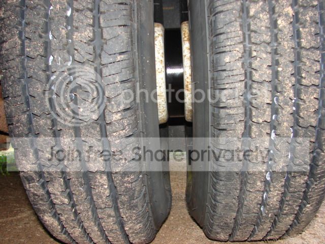

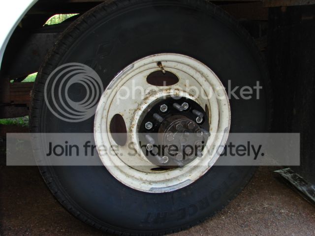

I have spacers between my dually rims...1.5" thick I think, they come with separate studs....they mount to the factory studs over the inner wheel, then the outer wheel mounts to a different set of studs on the spacer/adapter. I have pulled 10K + with them and no issues. They are steel spacers, not aluminum for my application though.
I have the same spacers. Excellent quality but expensive.
