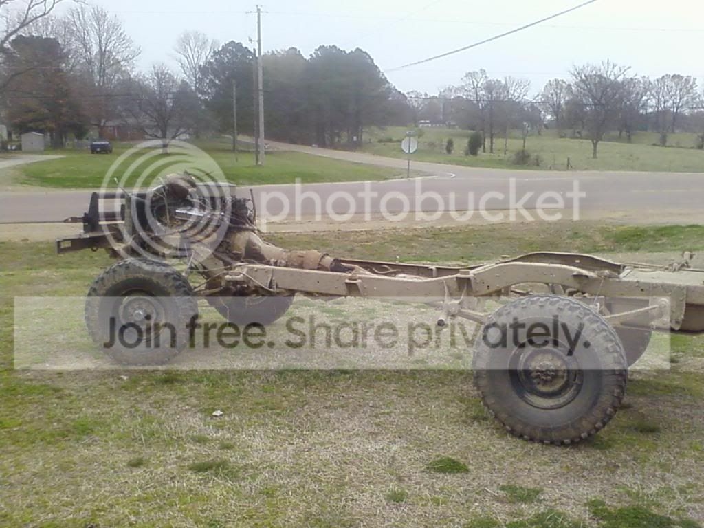

I put a CrewCab on a Sub frame, no problems except I had to make a cross member for the rear of the cab. Remember, all of the Suburban body mounts are outside of the frame. Here's a pic. of my '75 Sub frame.
When I was building the k30, I did the frame research. The only real difference that I found was the height of the channel. I measured my first half ton suburban frame and the k30 frame thickness and didn't find a difference. As far as wheelbase goes, the modifications needed to do the swap could be done on the suburban frame. Than the use of a body lift won't be needed. IMOA, the work to swap a sub onto a k30 frame isn't worth it. There is plenty of good vendors on here that can supply you with the suspension upgrades to put the 60 & 70 under the burban frame.
