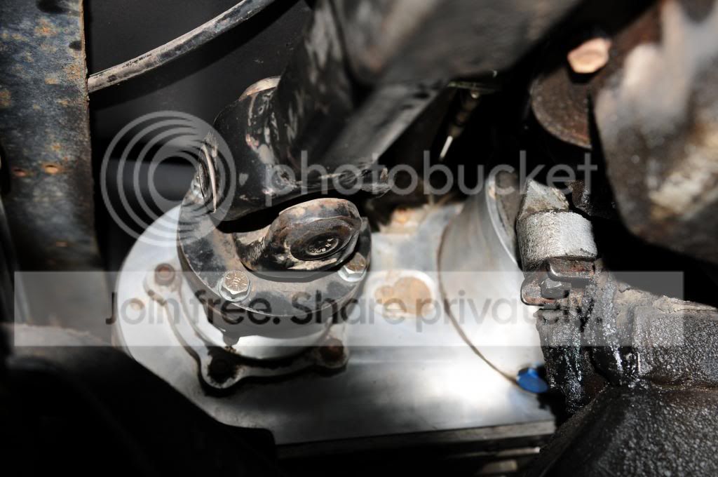

Just kidding, 1410s are more than enough but I had all these pieces laying around so I built this. I set of toyota flanges and a dana 60 stub where used in the building. Bolts are only there to hold it in
Oh yeah! :woot:
FYI, Spicer makes a 1480 yoke for D60/70's.
fyi spin the shifter link tab 180* for little more room to the flange mount.
then maybe allen drive button head bolt for extra room up from the bottom .
but you prob already knew that .
Need 1 u joint and should be good to go. With stuff laying around i built this shaft and the flanges for under 150 bucks.
