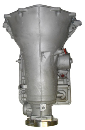

Wondering if someone has a quick picture of where the breathers are on a 241 and 700. Maybe a picture with the body off or drivetrain on the floor? :D:dunno:
Right now, mine are only stubs, I think. I would like to run some hose for them, maybe a loop or two, and get them out from under the body. :waytogo:
Thanks
where the hose is...
the small tube, top center...it's plastic & fragile, use care...

the little plastic one is going to be a bitch I know it
getting some kind of clamp on a tiny hose and NOT breaking the damn nipple, PFFF sounds fun. Might just try a small vacuum line and superglue it to the end, making sure I have plenty more plastic if I need to cut it off. At least the 241 is metal
I wouldnt worry about a clamp or glue. Just some hose thats a good fit. and tie it up somewhere so its not flopping around. shouldnt have any problems.
agreed, I don't need some wimpy little hose flapping around in the wind. :D
I believe someone here broke theirs, so they drilled & tapped it for a metal fitting. That may be the thing to do if you have it out ...
