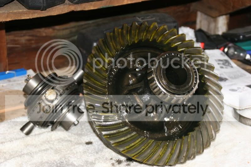

Detroit 225S10
Don't worry about the pic, it is deceiving. They don't make a detroit that replaces the carrier for the 10.5 as far as I have ever seen. Mine looks like the summit pic. Pull the carrier out, lose some stoc parts, and drop the detroit into the inside of the carrie and install the retaining pins.
pic of detroit for 14ff left of the carrier....
