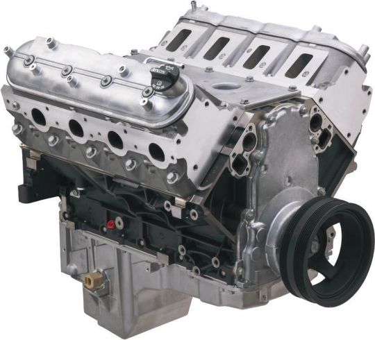

Which engine would you want in your 80s k5 blazer?
I will never go older than an L83 swap after @Fastereddie hooked up my 77. It's a little more up front outlay but the return has been awesome. Just a thought.
https://www.gmperformancemotor.com/category/LS.html
This brand new LS crate engine comes in at $4,000 and has 450HP
For the sake of keeping it stupid simple get the L31 long block, it’ll bolt right in place with minimal mods, you’ll have plenty more power over stock and be back in the drivers seat quickly if you stay after it.
If you aren’t afraid of work, LS swap it. Great power and dependability. I just know myself and it would take me a decade to do all of that work.
Sounds like the L31 would meet my needs for sure. I've searched and can't find a fully dressed price?
Any good suggestions on where you'd buy that engine? Really appreciate the help
