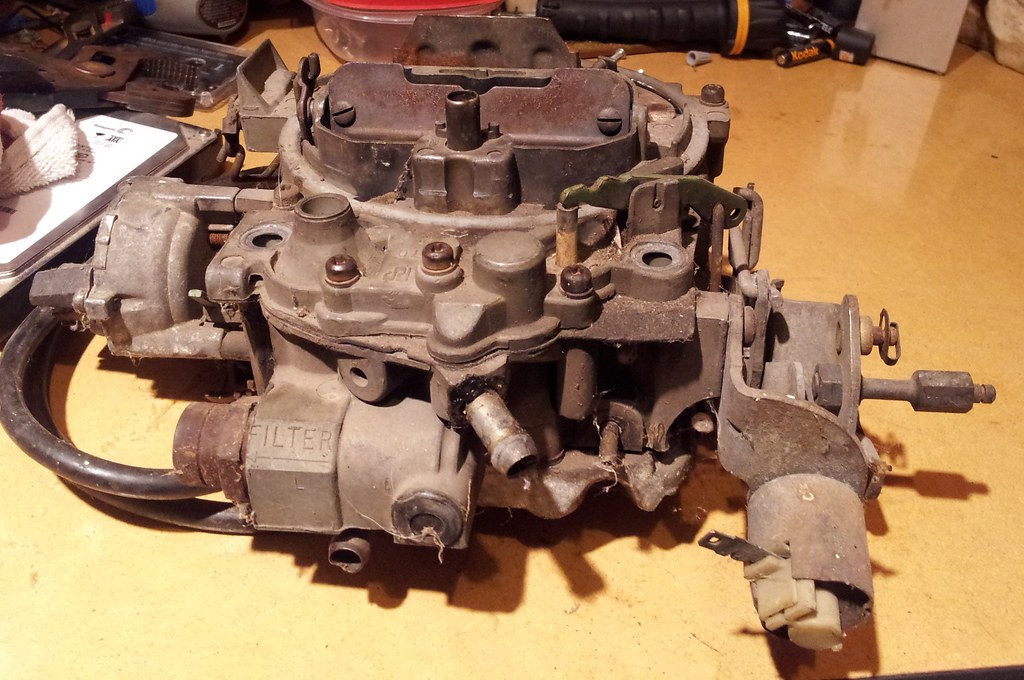

which qjet out of these 3
RootBreaker
3/4 ton status
Nov 29, 2001
6,998
1,423
Williamstown, NJ USA

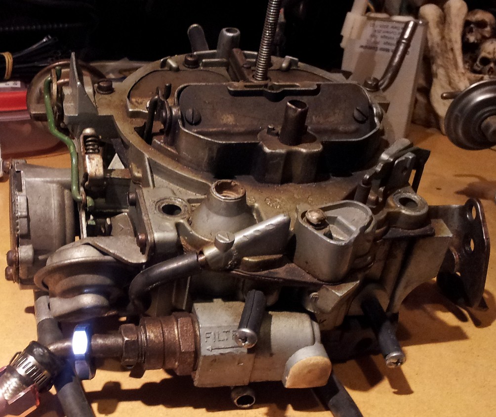

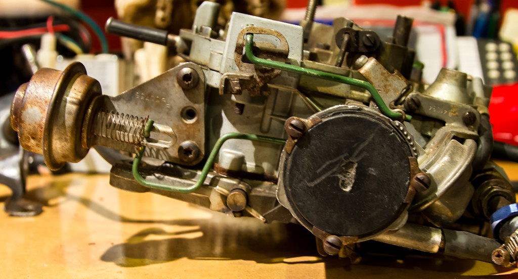

my immediate first reaction is #1.. but as Dave said get the numbers off the vertical so we know what we're working with... oh, and all 3 of those are electric choke if i'm seeing right..
Not #2, its a BOP, and would look goofy on a chevy with the front fuel fine
with the picks ive seen I say 1 or 3
EDIT: does the bottom of#3 look melted?
Yep, agree with this quote. Don't use this one. You would have to bend new fuel line to the filter or cut it down lower and rubber hose it to compensate for the wrong bend.
I wouldn't rule out electric chokes. Just need to get them to work properly. Like the others said about getting numbers off them, do that. Worst case scenario: you'll probably mix and match parts from either carb to make one good rebuilt one.

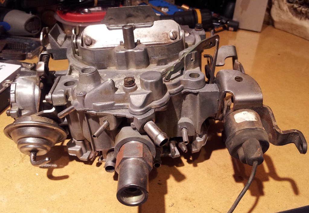

Ok here ya go...
17055038 2536
17058253 2507 BBC
17084226 3403
Sent from my Epic 4G Touch using Tapatalk
He said it has been.... They built a 500HP motor... Tried this carb...then rebuilt it.. No change.. Put a big Holley on it...
That carb has a lot of run time since the rebuild. Or they never cleaned it during the rebuilding. Which to me, is not a rebuild. Means they put new gaskets in and maybe set the float.
that's a hot air choke setup...not sure where the supply comes from though, usually somewhere on the intake manifold where it would heat up quickly.
Ok here ya go...
17055038 2536..this number doesn't come up, check it again...the numbers shown here represent 1975 model year w/ manual trans, but the 0 before the 38 relates to a single barrel carb:dunno: also shows it was built on the 253rd day of 1976
:dunno:
17058253 2507 BBC..78 model year Olds, manual trans. built on the 250th day of 1977
17084226 3403..84 model year, chevy automatic built on the 340th day of 1983
:dunno:
straight off.. your eyes see something different?
appreciate your help...
so some carb cleaner... and this will be the one to go with..
i need both front long bolts though or it would have been on already..

qjet is now on...
took a few adjustments but it is running.. not the best but better already!!!!
