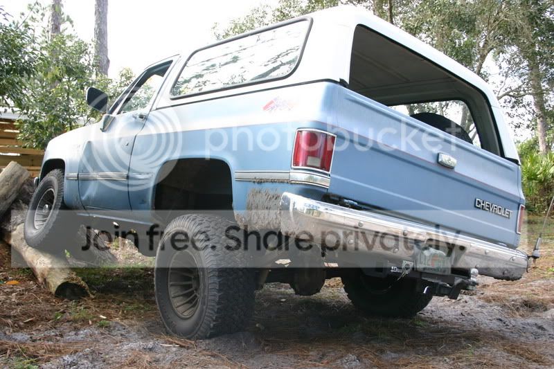

Tooka piece of flat bar bent it to contour the bumper. Then drilled 2 holes, and bolted it on, then drilled another for the spring mount, i just ran my coax up under the tailgait over the weather stripping stuff...
Yes the coax is broke...this was after my buddy wanted to play tag...needless to say his little POS s10 has a big dent behind the door now...

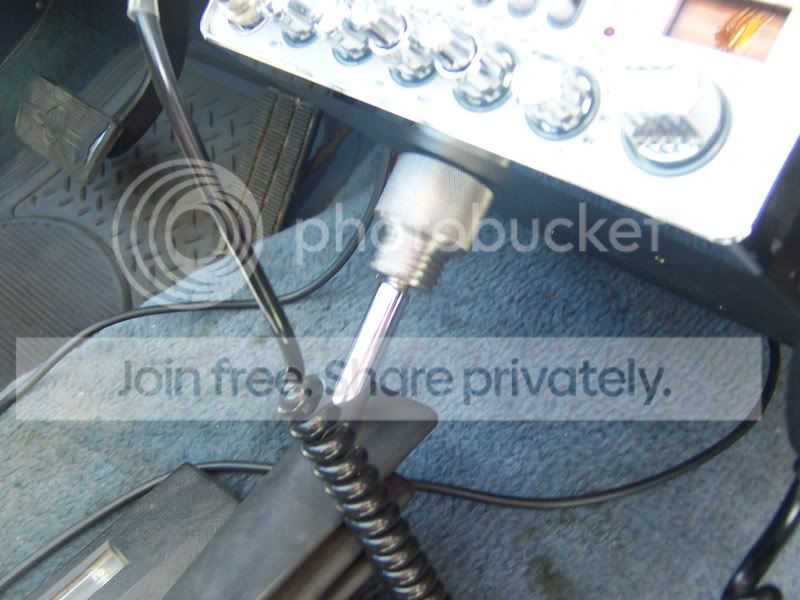

here's my 102" SS mounted to my rear bumper... I just drilled a hole, put the mount in and tightened the nut down on the other side... then the coax cable threads in from the bottom and the 102" whip threads in from the top...

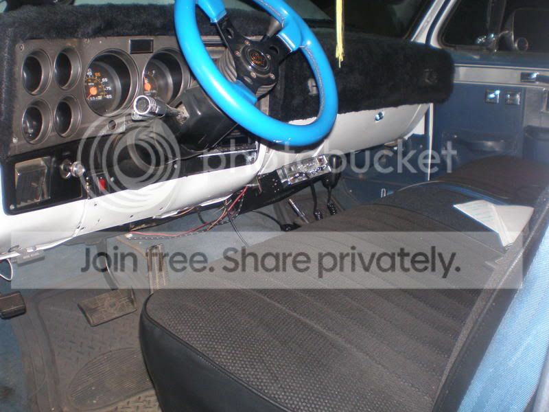

The third pic shows my cb mounted... the brackets that come with the Uniden CB's align perfectly with some factory holes below the ash tray... the transfer case shifter handle hits the cb so I machnied a shorter handle to go in its place...

And what uniden to you have in there is that a 78 or?
BTW Nice Rig

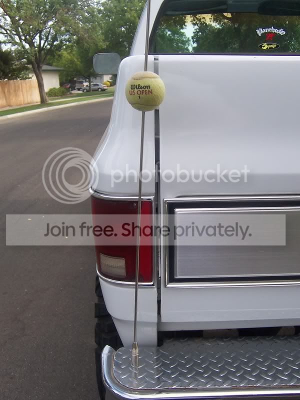

Uniden PC78 Elite... the tennis ball keeps the antenna from scratching the paint on my truck if the antenna flops around...
thanks, its a work in progress :)
haha of course it works...the antenna doesn't have very much surface area so the wind doesn't really whip it around too much but on the freeway it gets going sometimes (not a lot but enough to move that couple inches and hit the bed above the tail light) so the tennis ball just protects it...
