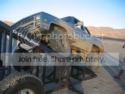

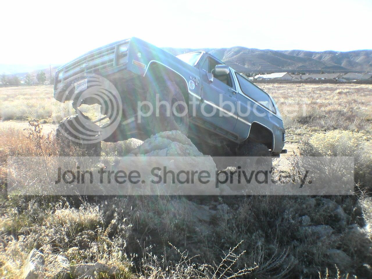

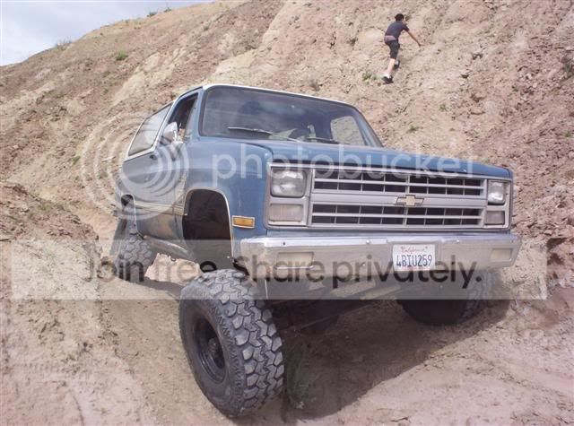

Havent truly tried mine out, but I know mine flexes like crazy, and I love it. I dont think you will find anyone who is disappointed by theirs. In the pic, your shackle is "flipped" around, pointing up, and it gives the lift.
