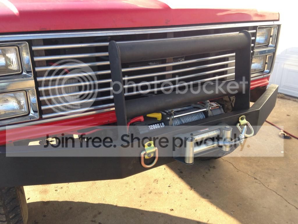

Oh the irony, after a long hiatus due to the death of my father I came back to show off my new bumper and what was the first topic on the page? Bumpers, so here's mine, I just finished it today. The mounting plate for the 12,000 winch is 3/4" thick (overkill, but it was free), and it's got 8 - 1/2" grade 8 bolts holding it to the frame rails.

Nice Ryoken :waytogo: It's got that Jersey 'don't F wit' me' look :rolleyes:

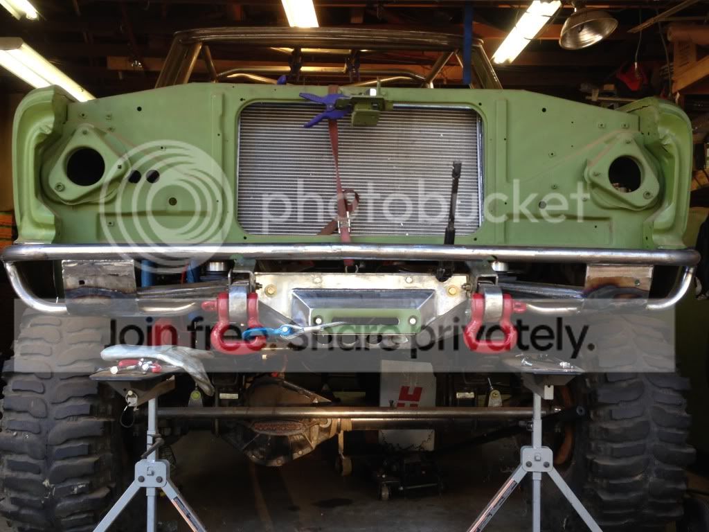

Progress on my rear bumper. It was originally designed in cardboard.
