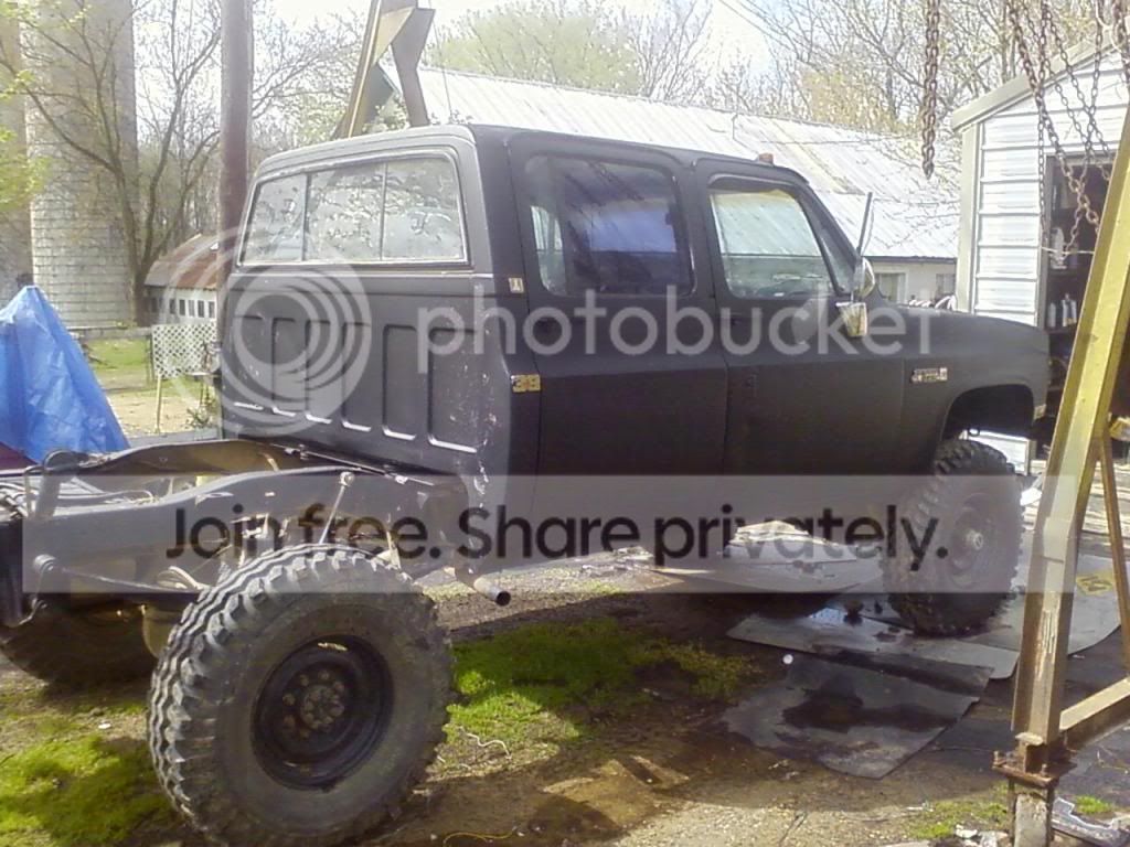

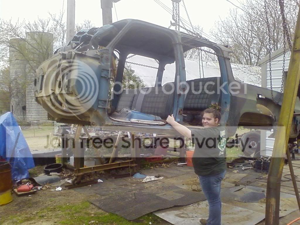

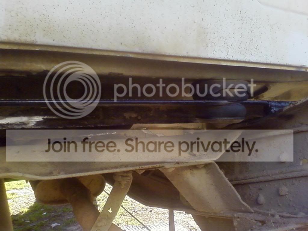

That'd be me. The outside mounts line up, the only one I had to make was the one at the back of the cab. I welded in a piece of angle with holes cut for the body mounts. You have to do more than transfer the removable trans hump too, the rear section isn't there for it to bolt to. I had to cut that section of floor from the Suburban floor and weld it into the crew cab floor.
