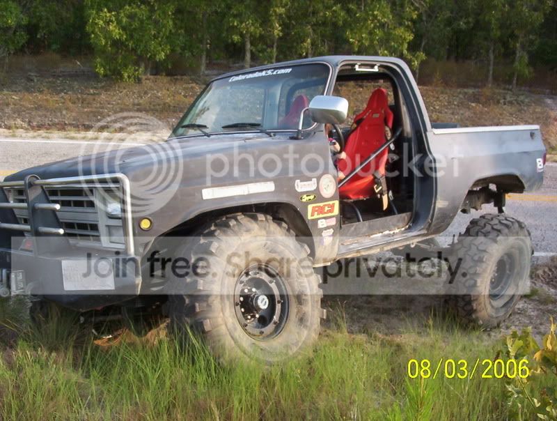

I'm running them. The amount of lift depends on what truck you get them out of. Mine are from a 1/2 ton 2wd. They only have 2 leafs with an overload. I added a 1" zero-rate and I would say I now have 4" lift (with a 4" ORD shackle flip) I am also using 8" long shackles from DIY4X. I plan on adding one, maybe two, more leafs to the pack. If you want pics you can click on my build thread (link in sig)

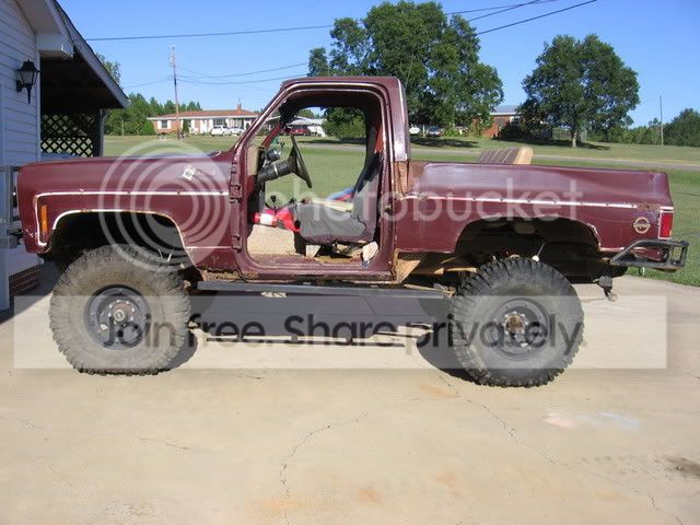

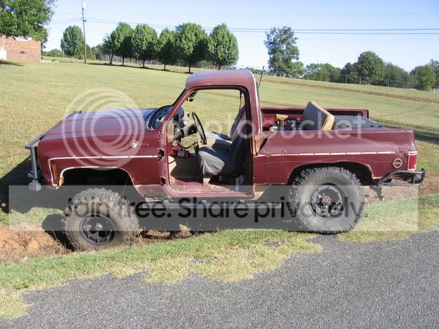

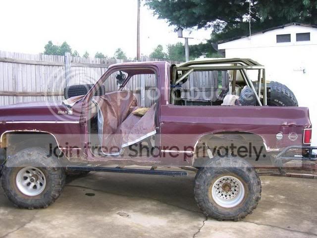

I'm running stock 2wd 63's also. I added a leaf to get a little extra lift. I also kept the same wheelbase. I moved the front hanger up 6.5in. The rear I moved back some also. I don't know how much because I installed a shackle flip with the stock shackles. I kept moving it till I got the shackle angle that I liked. I bent the right spring a year ago and I'm still running it.
Got any closeups of the mounting points for the rear springs? Did the swap move your axle forward?
Here ya go:
Those are ORD 4" shackle flip brackets flipped around and switched side-to-side. The front mount is in the stock location. About 5.5"s of wheelbase gained
My axle is in the same location. I moved the front hanger forward and the rear back.
