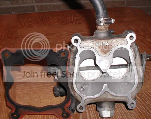

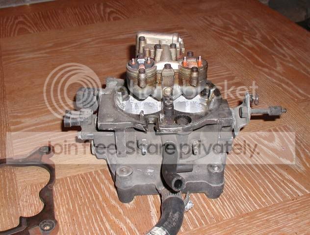

Have you ever seen what a TBI looks like for a 87-89 454? :D
Try the adaptor...if it doesn't work then swap the intake.

That adaptor was on 454's 87-89. 91 they went with a different intake like the one you have for the 350.
