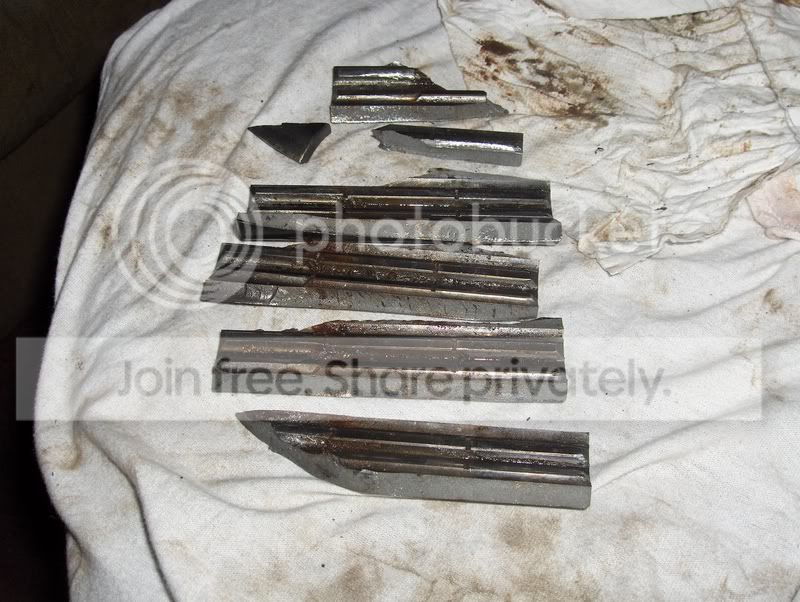

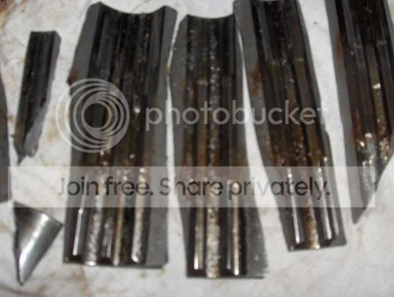

this one??
That's not an adaptor, that's a coupler (nice job BTW...)
