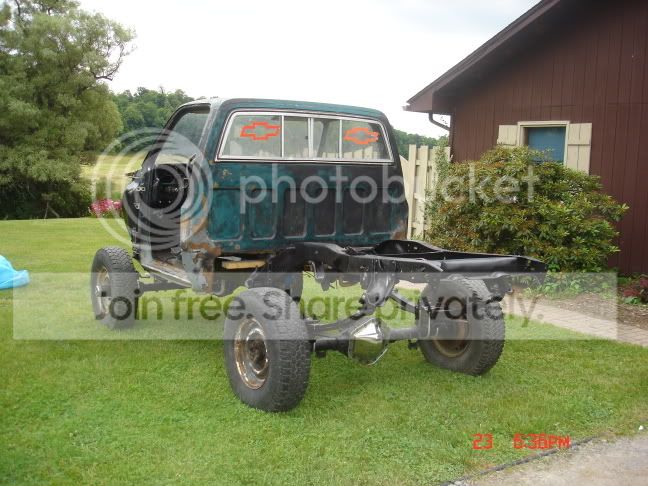

I used a crossmember from a pickup and made mounts to bolt it to the frame. Here is the crossmember bolted to the cab.
Now here is the crossmember bolted to the mounts i made. It's a plate welded to the frame with a gusset in the front and rear.
inside view
Semi-finished product(still need to make a flatbed and do a little bodywork/paint the cab and doors)

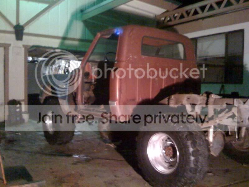

ive got a 67 cab going on a 76 k5 frame
still gotta work out the body mounts. none line up. but the rear cab mounts are close
