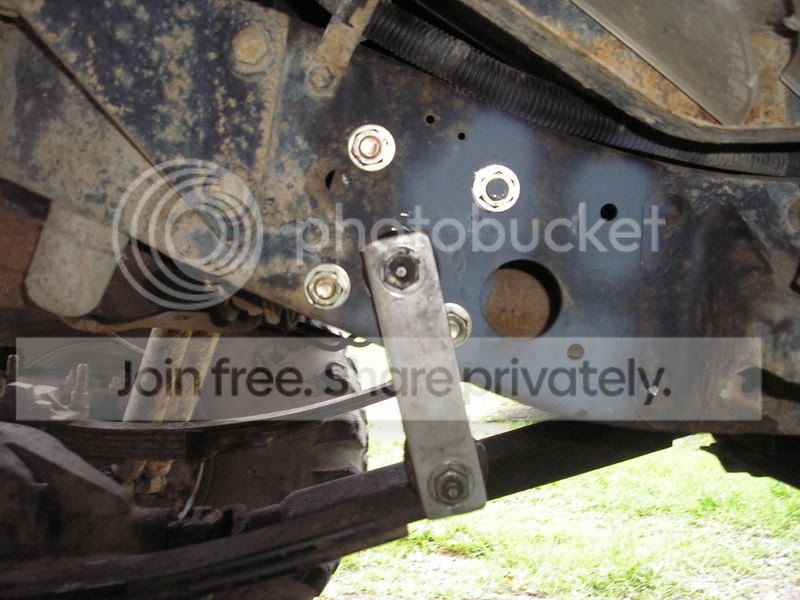

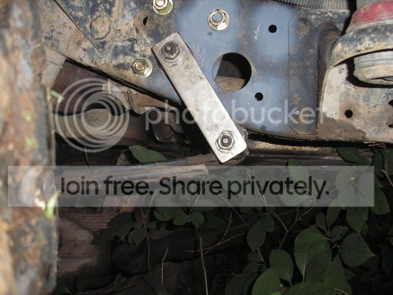

I did it just shy of a year ago to try and get at least a little flex out of my super stiff Rough Country 6" springs. It did seem to soften up the ride quite a bit and improve flex, but with my springs it's not like I'm going to max out an RTI ramp or anything. I think my shackles are 7" hole to hole (or close to that) and I used the top, front hole as a guide to move everything forward. Here are a few pics:
thanks guys, the pictures helps a ton. im going to tackle this in the next few days.
