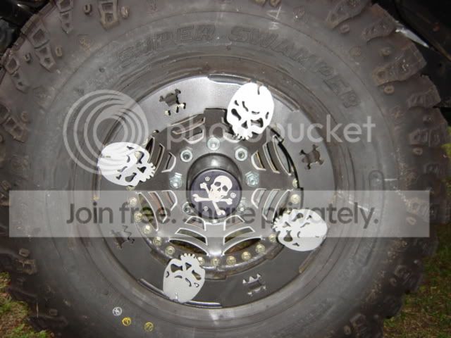

H1s, recentered to 3.75. Still have the mag insterted but would like to go to pvc in the future. 38.5x16x16.5 swampers now.
IMO the h1s are it cuz you have a double bead lock to begin with, and its only 8 or 12 bolts vers 30ish on others. Its just way quicker to change a tire. Not knocking the others, just my opnion.
