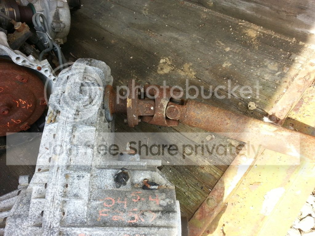

I will post the pic in a minute, but 04 and up? Superdutys do have a pretty beefy front cv, I saw a t case at a pnp recently and snapped a pic of the cv for future reference
