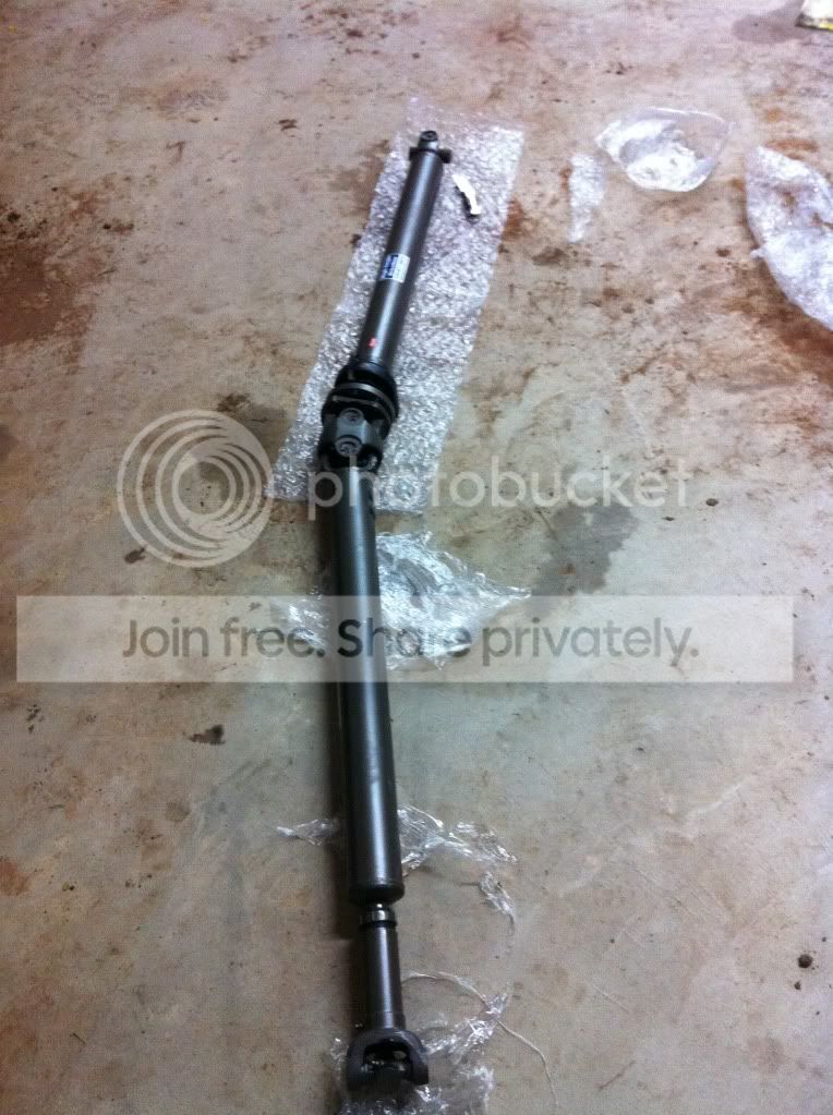

I have 3 of them sitting in my old parts bin at my folk's place down South. Mine were 1350 and were a direct bolt in for my Tahoe with a 14BSF and a SYE'd NP241 Even the right length, lol!
I wound up getting an aftermarket shaft with a much longer slip though. I easily over extended the SD shafts (also compressed them too much too... Stupid wheel travel, lol)

Lol, my brother just bought an 86 1 ton crew cab TBI 454 4 speed 4wd. And it has a driveshaft I could use as a stripper pole in a 12ft vaulted ceiling house.
