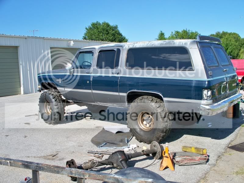

i have 40''x17''x15'' tires on a 15x8 wheel,no prob,run all the time,never need a bead lock.2 years been doin this no crazy wear prob.
Heres what it looks like
